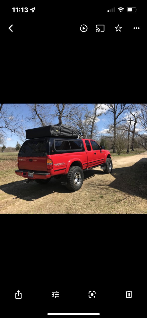

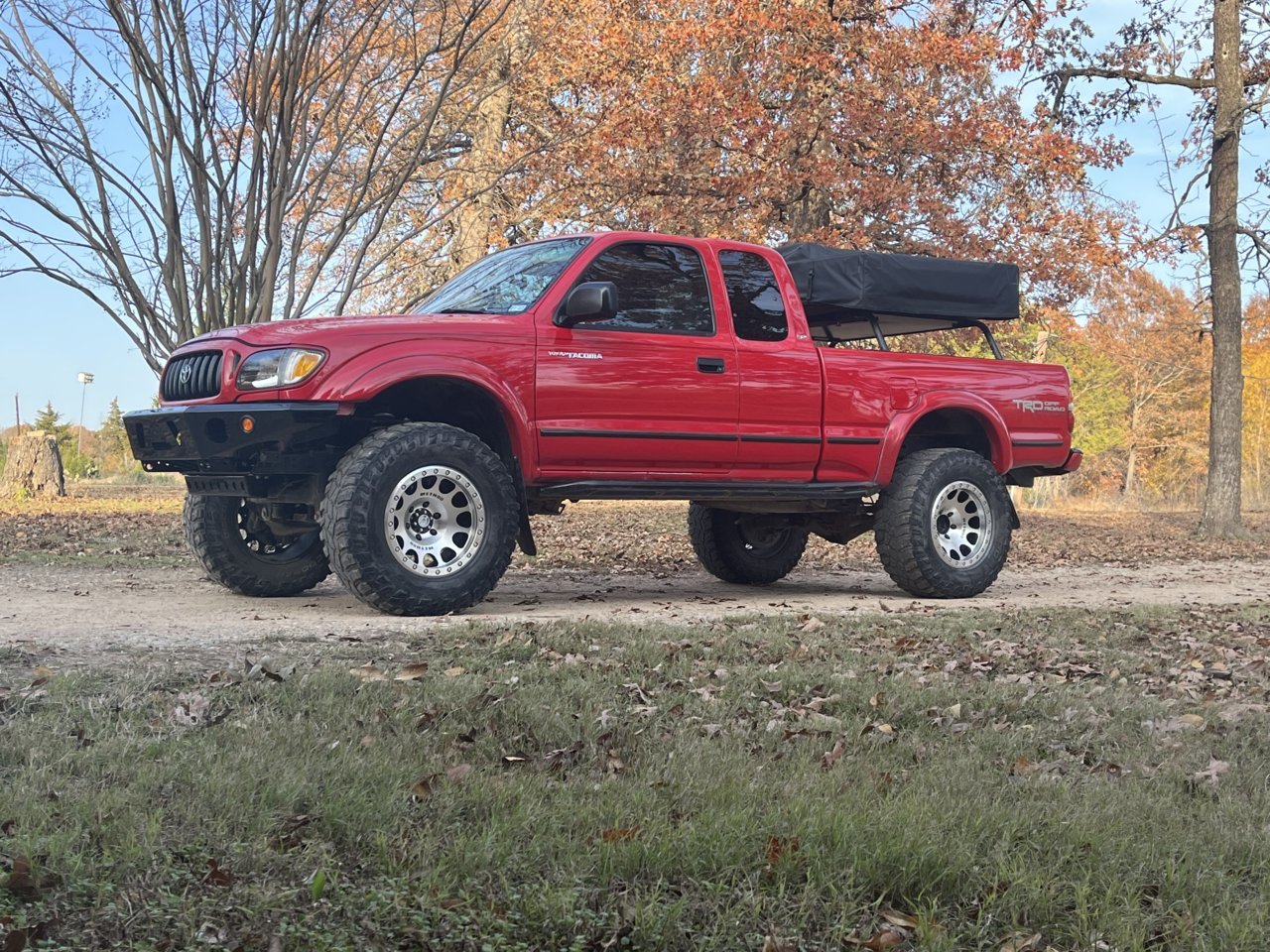

    Bought some angle iron. Mounted two strips to top of topper shell. The the other two on the tent and bolted them together when on truck.
    And in hot part of the year ditch the camper n built this rack from 1 1/2 tubing.
