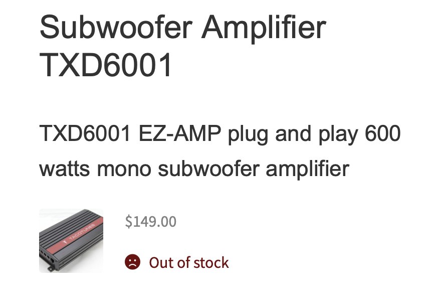

    I would be running the same amp. Let me link it to you. It's their proprietary one. Im 90% sure its this one right here: https://*********.com/shop//z-amps-...-4-channel-x-100-watts-rms-class-d-amplifier/
    I went back and looked at my order: this is the kit Im running: toyota-tacoma-add-subwoofer-packaged-system-kicker-comp-vr-10-subwoofer-*********-600-watt-amp

    You shouldn't need a splitter if you're using the same amp and only that amp for subs. You will change the final nominal impedance the amp sees though. Need moar info. What's the impedance of the sub you're using now and what's the minimum impedance of that amp (would suspect no less than 2 ohm stable)? How much power does that amp make? (RMS)
