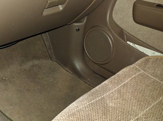

    First, you need to remove the plastic door sill, which is just four screws. After that, you can remove the kick panel by pulling toward the back of the truck - it's held on by a couple of clips (no fasteners). At that point, if you look down at the lower opening, you'll see a single red wire that goes to the door switch. That's the one you'll want to cut into, extend the wires, and switch.

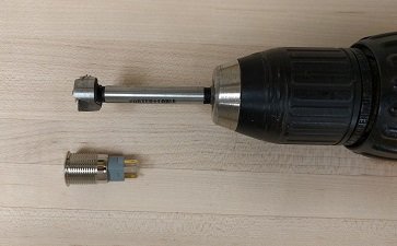

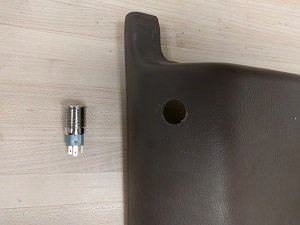

    So, the next step was mounting. Originally I'd planned to put these on my dash, likely above the clutch start cancel but as I looked more closely I realized that it'd be nice to put them in the kick panel, on the "45 degree angle" facing the cab. So, out with the 3/8" drill bit (fit the 16mm perfectly) to drill a hole about an inch down from the top. The switch then went in, and I used the rubber seal on the back of the kick panel as a sort of locking washer for the nut.

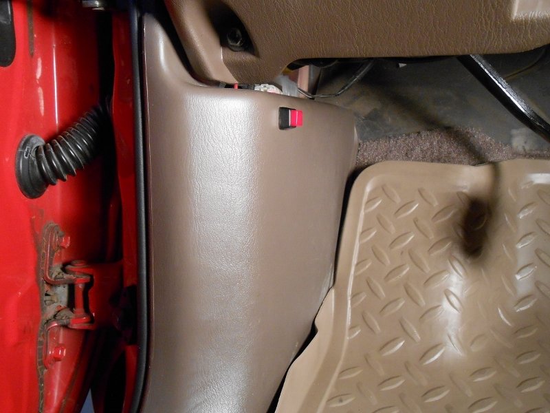

    Then, it's as simple as soldering up the switch (in the case of this switch, the blue and green wires from the harness are the switched leads), activating some shrink tubing over the connections, and putting everything back together. And of course, you have to repeat for each side of the cab, since each door switch independently controls all courtesy + cabin lights. When it's all done, these small switches are pretty nice looking on the kick panel - noticeable enough that someone might say "hey, what's that for?" but not intrusive in any way, and not easily tripped.
