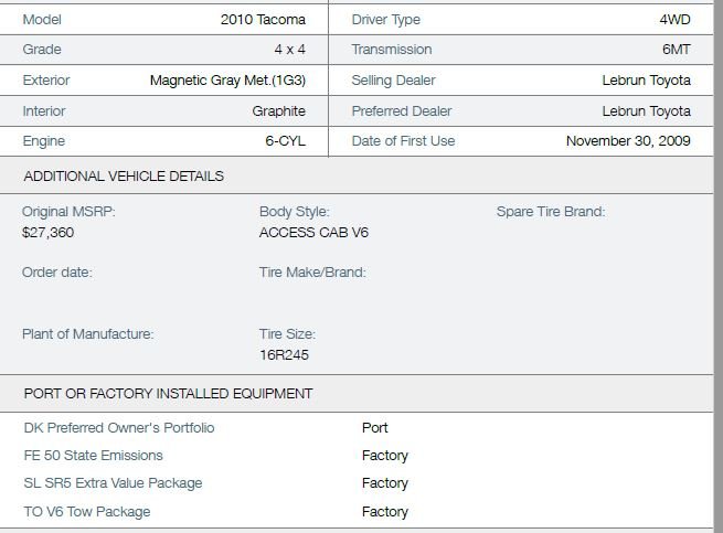

    dmarsh15
    dmarsh15 Well-Known Member
    Apr 4, 2017
    #215315
    215
    David
    Rochester, NY
    2010 Tacoma V6 SR5 MT ACLB
    Function Over Form
    When I go to the customer section of the Toyota website where I registered myself as the owner, the below came up for the specs of my truck. Apparently I have the V6 Tow Package and didnt even realize it. I'm not sure I would trust the hitch with a heavy load with how much more rust is on it than the frame.
