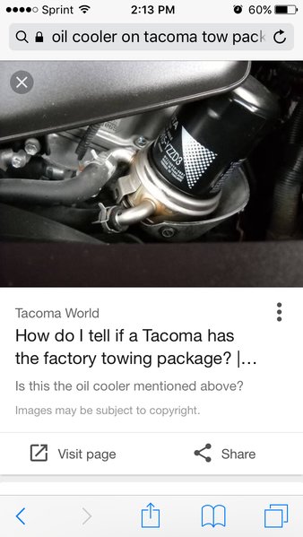

    That looks legit - mine on a different site did not read that way -

    Look for this little donut under the oil filter. Its the oil cooler(standard on tow package from factory)
    Edited to add: tow package trucks also come standard with a group 27F battery. These are the first two things id check that are easy to spot.

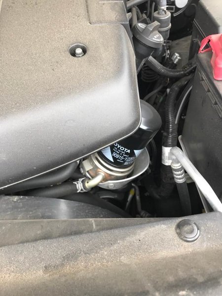

    So my wife went out and took this photo of our oil filter area, which is attached. Looks like an oil cooler, yes? And to clarify, the truck does have a hitch receiver. Thanks for all the help you guys...

    Yes that's an oil cooler. Do you have the 7 pin wiring connector? It's in the back close to the hitch. Folks rip it off regularly off roading.

    yep, that's it
