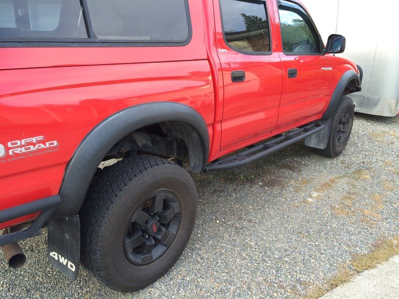

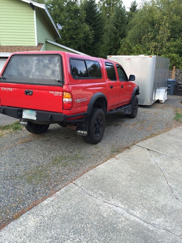

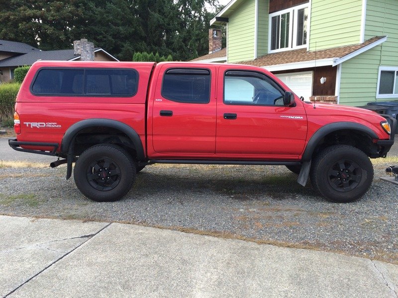

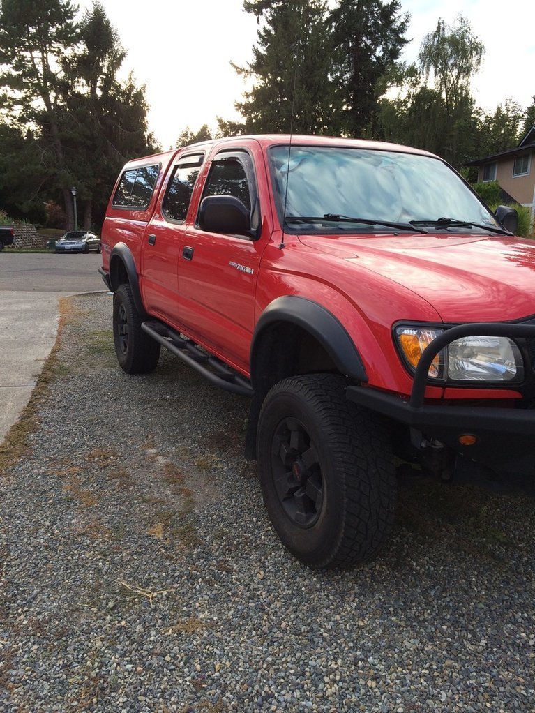

  10. Aug 28, 2015 at 8:38 AM
    gerriputo
    gerriputo [OP] Well-Known Member
    Jul 8, 2015
    #159028
    197
    Now he needs some bigger tires.
