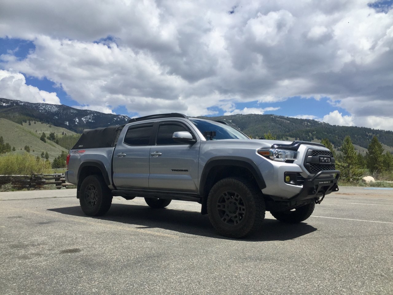

    Wheels / Tires / Softopper / Fox 2.5's ext travel set to 2.5" of lift/ 600 pound 14" springs / Total Chaos UCAs/ ARB Summit Series Bumper / SOS Offroad Sliders /OV Tune / SPOD / Ditchlights /10K winch/ a bunch of other stuff
