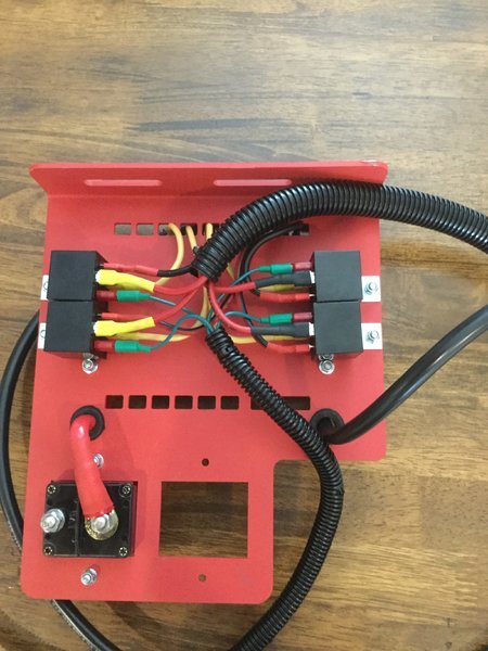

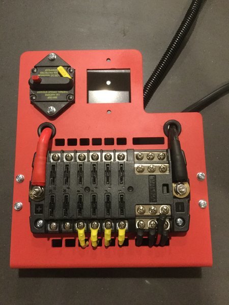

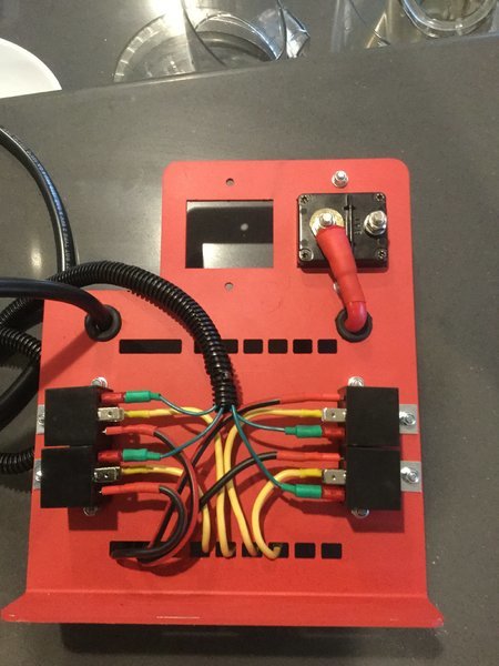

    Ok let me know if you spot anything that doesn't look correct.
    Green wires from switches going to relay posts 86
    Yellow wires from fuse block to relay posts 30
    Black/red from relay posts 85 to ground post on fuse block.
    Relay posts 87 for running wires to the lights.
    I plastidipped the Pelfreybilt fuse panel thinking it might soften the edges where the wires pass through.
