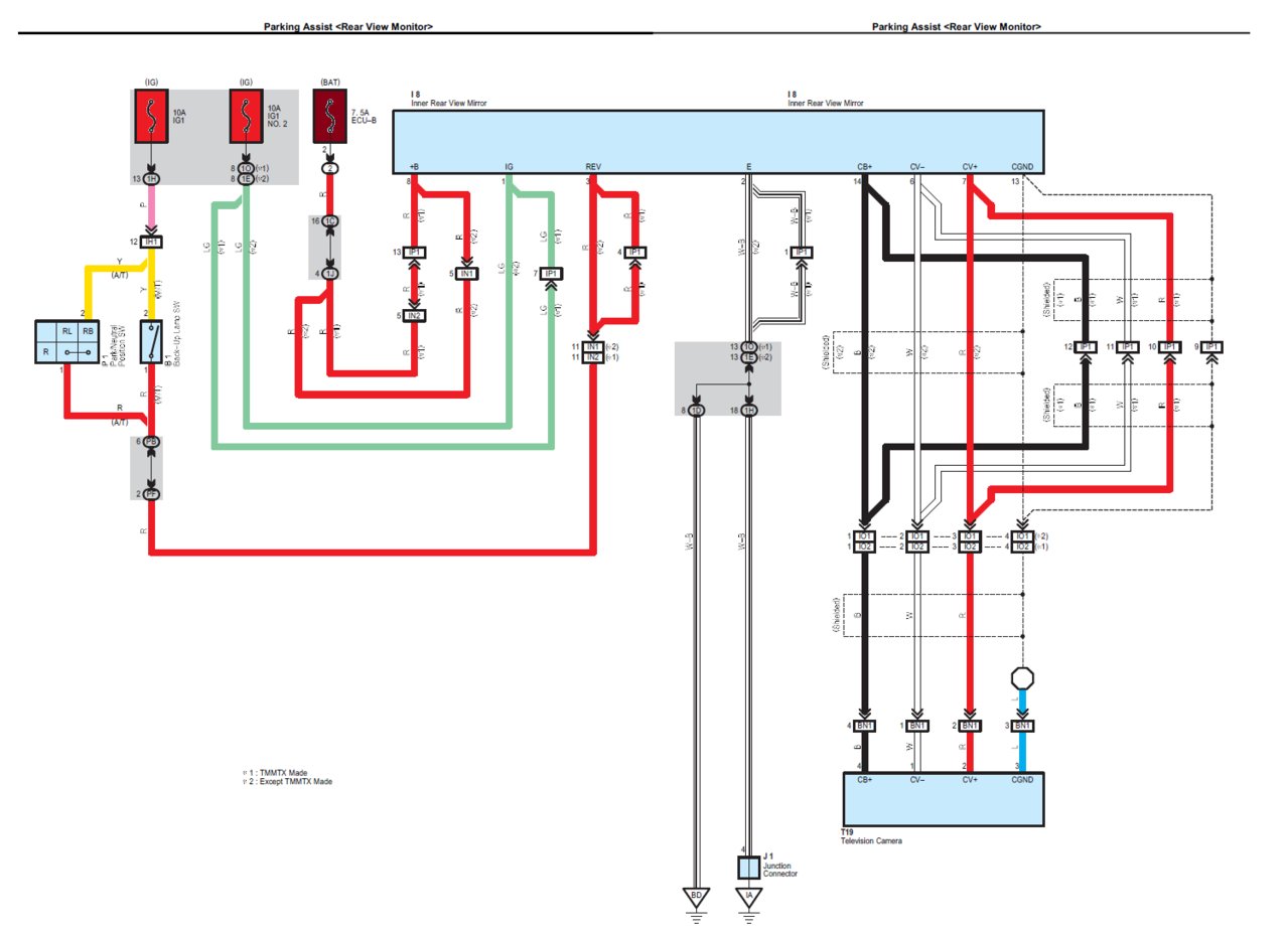

    i have a 2012 tacoma with the regular unit that does not have the screen. as such, my rearview camera comes up on my rearview mirror. my headunit is having issues and am considering getting an oem unit to replace it so i can have the rear view on the screen. i've found a few new and used ones for a very reasonable price (less than $150). i like oem stuff and the look since its usually less flashy than aftermarket. i'm curious if anyone knows if another oem unit, such as the 57053, if installed, will display the rearview when i go to reverse? this is assuming if installed correctly. details on connecting the camera in my situation to a 57053 unit would be great if someone knows how.
    any insight much appreciated.
    thanks

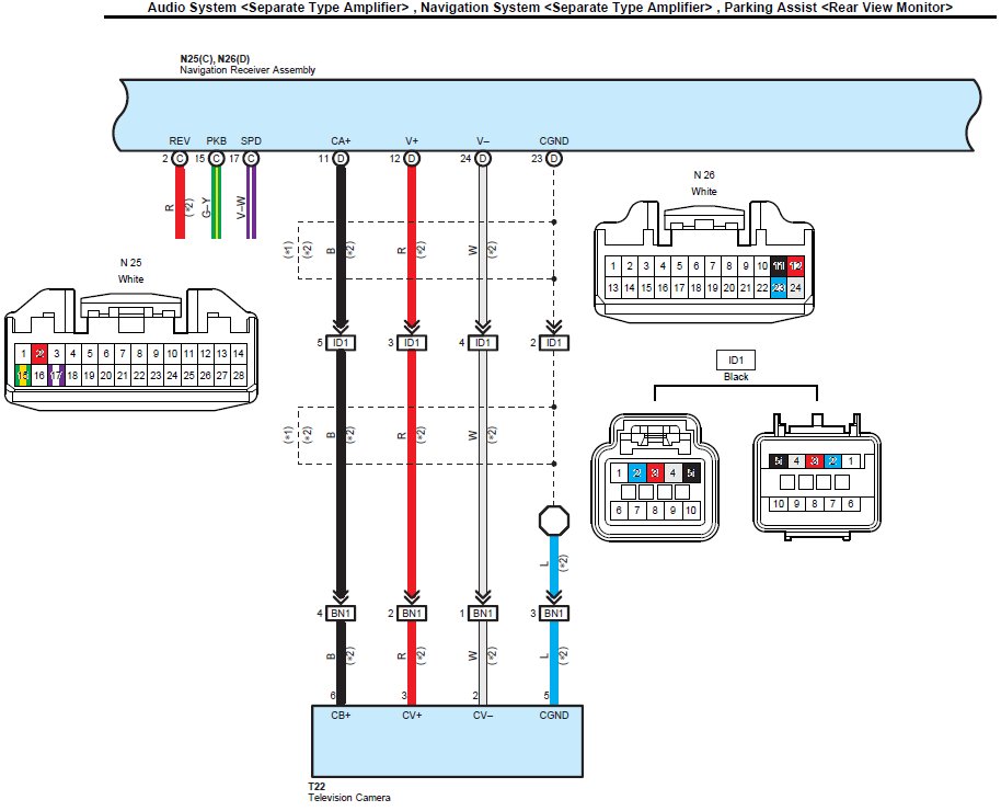

    Ric, this what your Tacoma has:

    impressive info - thank you

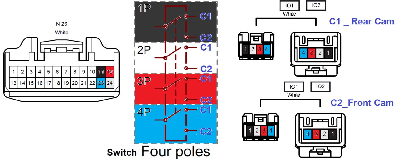

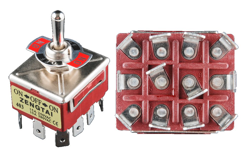

    Maybe...
    Quad On-Off-On switch
    Rear to front camera select.
    Still need to add reverse select switch also...
