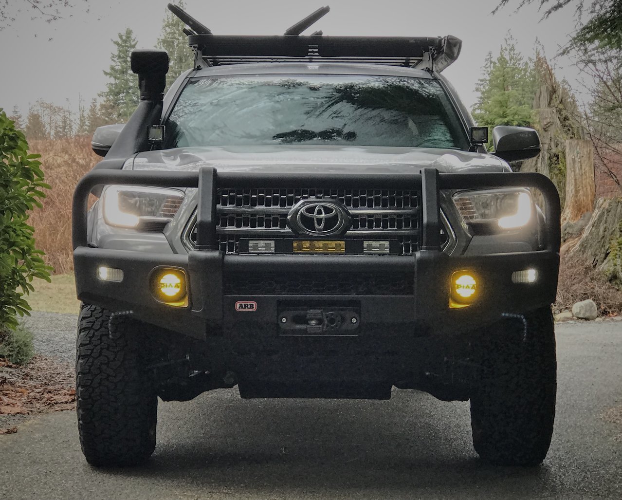

    We recently made the switch. Haven’t noticed any changes so far: running BP-51’ set heavy.

    Goddamn that looks beautiful. What is BP-51 set heavy?

    We are running the OME suspension with BP-51 shocks and struts. They are adjustable for different conditions.
