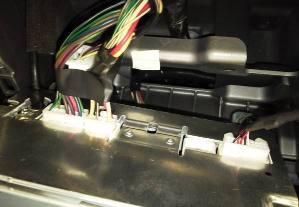

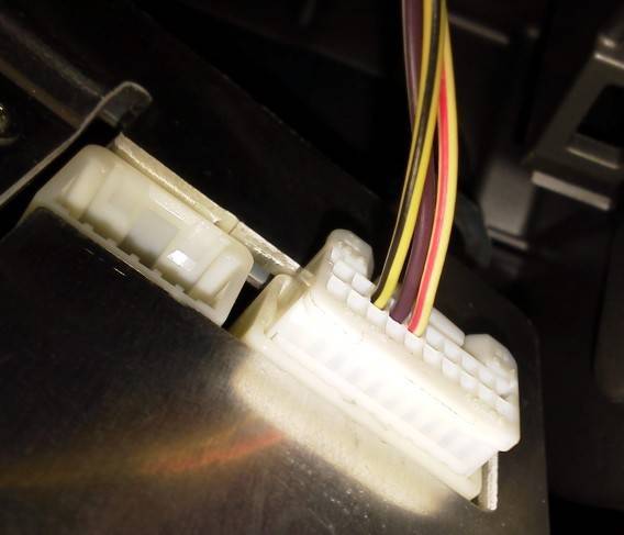

    I had to unplug this 20 pin from the back of the stereo. No idea what it does since everything still worked when I removed it.
    After plugging in the new aux cable and running it down behind dash to center console, I just taped the old plug up so it won't rattle.

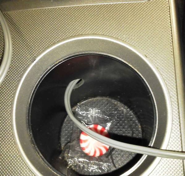

    The line wasn't long enough to go past the front cup holders so I added an extension that I had layin around so that I could run back to here. I'll put a grommet on that some day.
    And the proof. The sound is really quiet so next I'll tackle that but at least it works. The display says "CD in" because there really is a CD in there. Pushing the disc-aux button cycles between the 2 options.
