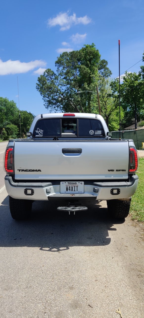

    What lights are those in the bumper.
    (sorry for the thread hijack)

    My firestik is the revised fiberglass version. It is VERY bendy. Add in a spring base and it's bulletproof. I've whacked many drive thru posts, branches and the antenna hasn't flinched.
    The brand is offroadtown. Haven't had any leaks and it's primarily used as my reverse lights. Haven't ponied up for some nice rigids yet

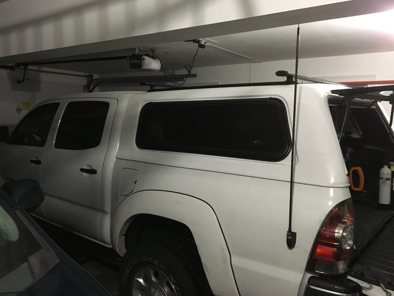

    I have a President CB...I like it a lot. Also have a GMRS license and several handhelds but around here most use CB instead of GMRS or HAM.
    Since I have a cap, I have a side body mount from Firestik and a 3’ antenna that clears my garage door. SWR is 1.2. Yes, the side body mount requires drilling two holes in your truck. That didn’t bother me after installing my snorkel.
