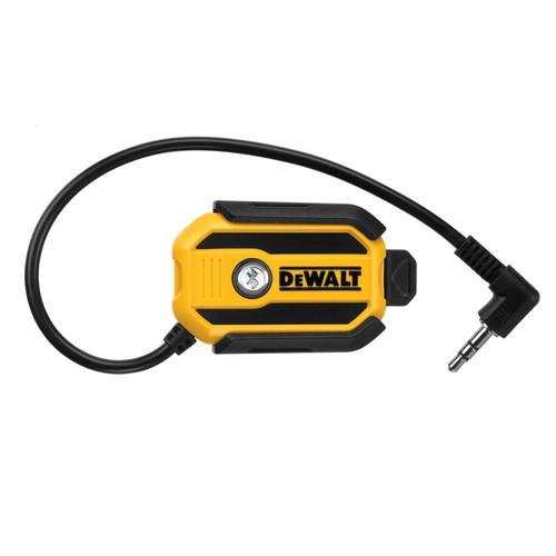

    For an old car that had a Bose sound system and a tape deck that I wanted Bluetooth in but didn't want to tear out the radio I got one of these DeWalt BT receivers and used a F-F coupler to the cassette adapter and it had a 'factory Bluetooth™' you could try one of those plugged directly into the AUX port.
    If it works then you could do like I did and semi permanently mount it.
    I used some 3M trim adhesive to stick the base mount to the console and had a very short USB cable to a USB charger in the cigarette lighter outlet and left it plugged in all the time as the battery life was rather short otherwise but it would play and charge.
    Got rid of the car long ago but I still use the BT adapter to give some old computer speakers in the garage wireless capability.
    I suspect the reason you have issue with your phone and the aux port is stacking tolerances and that the radio is almost guaranteed to only accept 3 pin 3.5mm jacks whereas your phone is a 4pin 3.5mm jack and if two internal pins touch one plug pin then the head unit detects an anomaly and disconnects to protect itself giving you the not compatible error.
    You could also try another cable to see if it works better but again may have the same issues.
