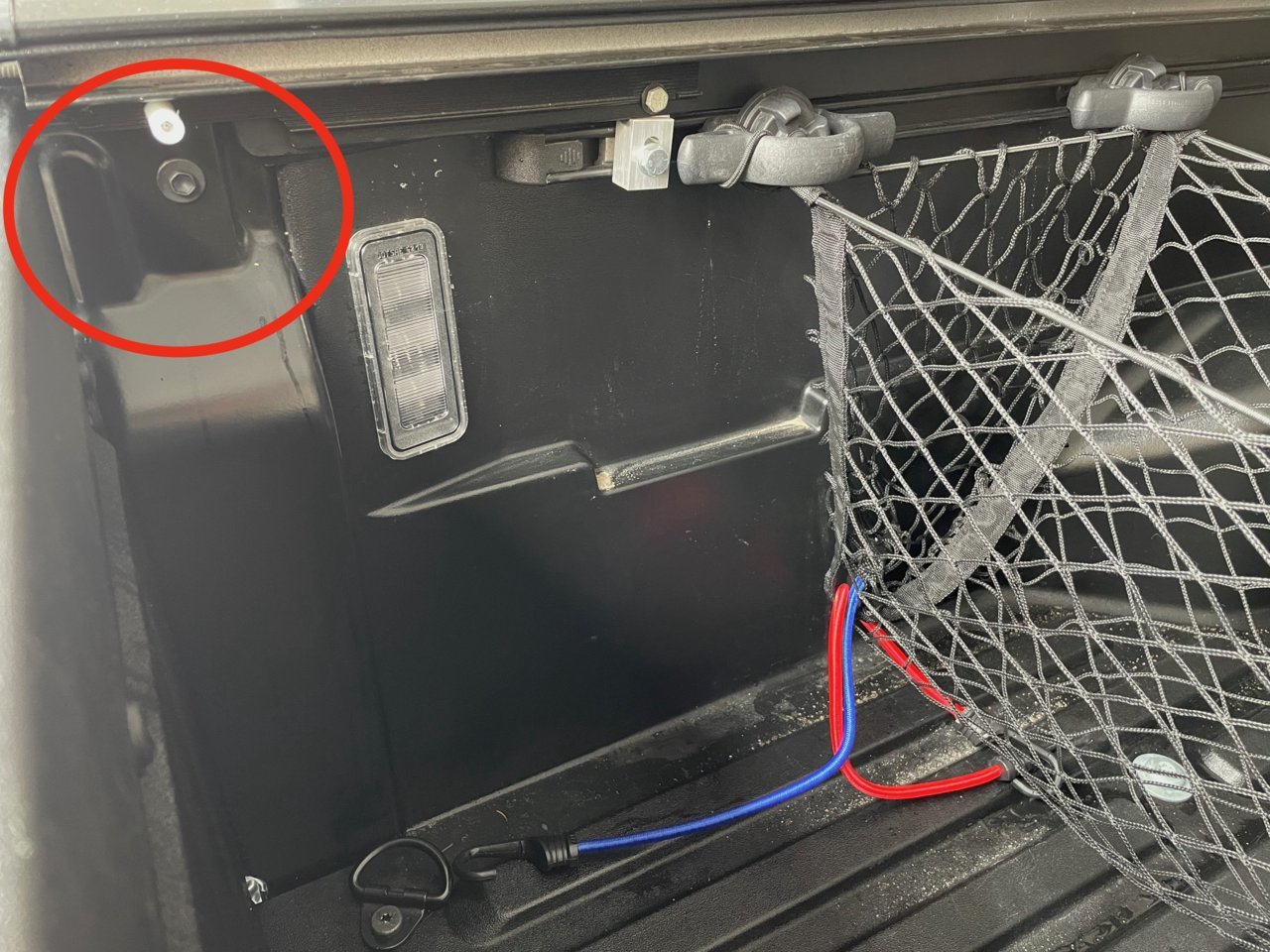

    I'm looking to add a cargo tie down to the very back of my bed wall next to the door so I can have a cargo net right up agains the back. See red circle in attached pic. Any suggestions on hardware and placement? I'm worried about drilling into anything important. TIA.

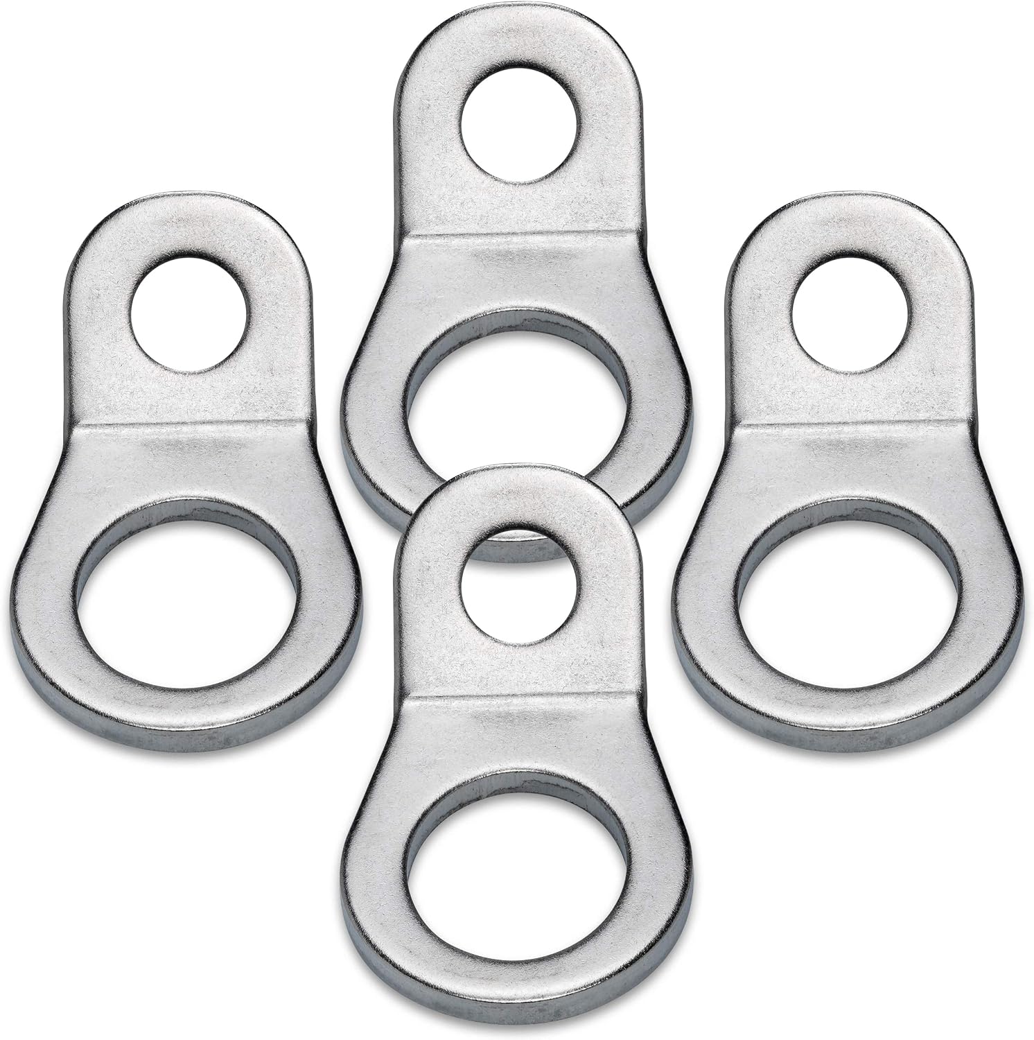

    https://www.amazon.com/KAPMOZ-Ancho...ywords=bolt+down+d+ring&qid=1614106647&sr=8-9
    Like these?

    Put either a 2 inch or 3 inch v ring on that bolt you circled, and tie the bottom of the net to the existing rings on the bed.

    Thanks for the quick responses. I like those V rings. I was thinking of using that bolt, but since I don't really know what it does, I was wary about taking it off.

    I just holds the top of part #3 to the bed and rails along with some other bits behind it. Should be fine to use it as a light duty tiedown.

    @Juisebocks - thanks. Where did you get that technical drawing from? And do you have any idea about the other bits behind? I'm only concerned about something falling off on the backside and not being able to get to it...

    An alternative option might be bed stiffeners. I have the Total Chaos ones, and they are the tie down points that I seem to use the most in the truck. Dual purpose, and each side gives you 3 points. Just a thought ;)

    Thanks for the tips everyone. I'm going to try the total chaos bed stiffeners and see how it works out.
