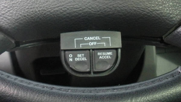

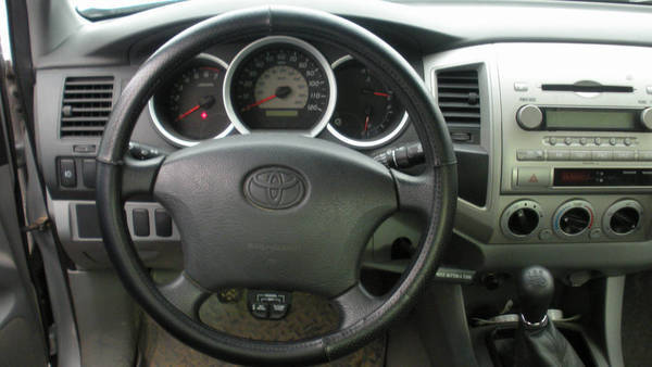

    I got this cruise control for my 2008 SR5 reg cab for like $150. If you are worried about the toyota one not working on a non SR5 this one just clips into the plastic on the steering wheel. I'm perfectly happy with it.

    just did a install same truck tusday 2011 manual rostra makes the kit works just like factory
    make sure to get the clutch switch 250-4206
    your truck may be pre-wired if not this kit will still work!!
    http://rostra.com/manuals/250-1836_Form5188C.pdf

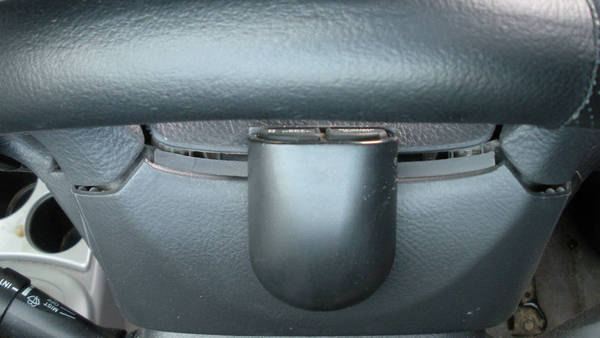

    Well dont try to deal with the stealership. I tried not to say that but what else can I think. The Rostra kit worked great even if your truck is not prewired and my truck was not. I had four wires to run from the drivers side to the passenger side and used a coat hanger to pull them across from one side to the other. I also had to install the clutch switch. Yep it was a pita. My biggest trouble was no room to rotate the clutch switch to screw it inplace of the stop bolt on the clutch pedal. The wires were made onto it and no room for them to rotate to screw it in. How they stayed on there I have no idea. I pulled on them for 10 min to turn the switch about 12 rounds or so. All I can say is its made tough and thank you Rostra for making a great system. Im no professional mechanic and it took me about four hours and two sore knees to get her done but Im cruzing now with a push of a button. I have one issue maybe someone can answer. When I push the brake pedal the cruise drops out and will not resume the cruise light starts blinking and I have to turn it off then back on to reset it. ? Not sure if thats the correct way it is supposed to work but I can deal with that. I think my corolla with resume after pushing the brake pedal. If I had to guess I would say this is the factory cruise toyota installs on our trucks. Looks indentical to my corolla.
