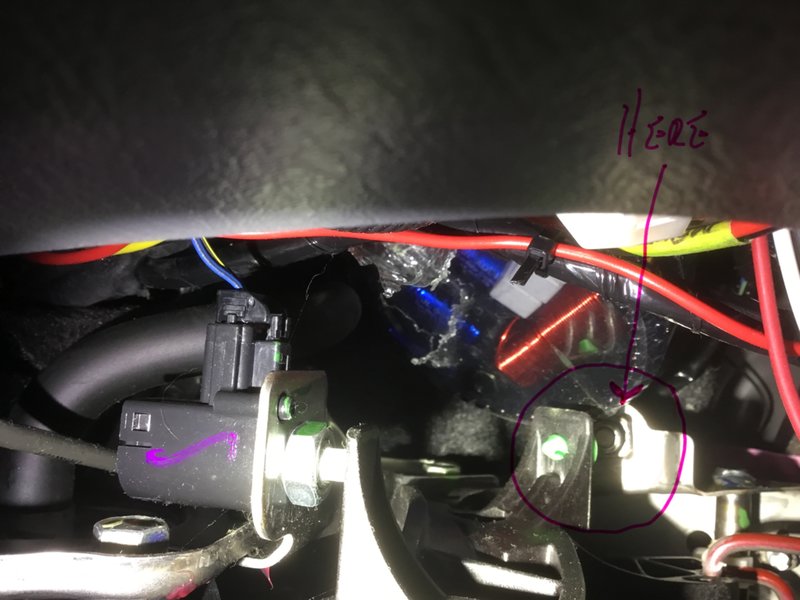

  6. Dec 27, 2018 at 12:29 PM
    #26
    Muddinfun
    Muddinfun Well-Known Member
    Apr 17, 2017
    #216500
    7,489
    If you look up under at the clutch pedal, there is a bolt with a jamb nut that stops the pedal from travelling too far upward. This must be removed, and the switch installed with the jamb nut, keeping the compressed length of the switch the same as the bolt was to keep the pedal freeplay adjustment the same as it was.

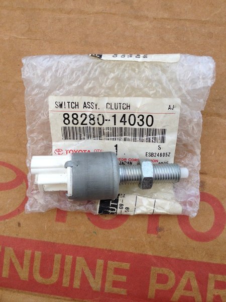

  7. Dec 27, 2018 at 2:08 PM
    #27
    gutsy
    gutsy Well-Known Member
    Dec 15, 2018
    #275927
    84
    Dave
    Yardville, NJ
    Black 2010, 4 Cyl Manual TRD
    Added intermittent wipers, rear camera with Rear view mirror LED, remote door locks, Cruise control
    Hey Mudinfun,
    Thanks for the info along with the pics, which helps quite a bit. Is the bolt and jam nut difficult to get to and remove? I assume part number 88280-4206 is the one I need for my 2010? I searched online and Amazon has it, but shows that it's not compatible with my 2010. Also, where is the plug that connects to the clutch switch once it's installed?
    Thanks again!
  8. Dec 27, 2018 at 2:14 PM
    #28
    T@co_Pr3runn3r
    T@co_Pr3runn3r XXXXXXXXXXXXXXXXXXX
    Jan 20, 2009
    #12767
    14,642
    08 RC Prerunner SR5
    Plug is way up in corner above left foot. Look at the switch plug and look for it up in corner of cab right at lower dash level.......mine was right at edge of top of carpet or the insulation stuff.

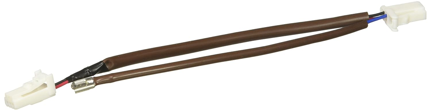

  10. Dec 27, 2018 at 5:49 PM
    #30
    Beerline123
    Beerline123 Well-Known Member
    Apr 1, 2014
    #126719
    409
    07 Tacoma access 4x4
    Hey newfiebruh, could you post a pic of the hookup. I have the same wires and am confused about the ground wire. Where did the brown wire with the crimped end go. Tia

  12. Dec 27, 2018 at 7:04 PM
    #32
    Newfiebruh
    Newfiebruh [OP] Well-Known Member
    Feb 7, 2018
    #243750
    945
    Tom
    2010 Black sand pearl access cab Base
    LED's, Tonneau cover, Fog lights, Front mud flaps, Cooper discoverer a/t3 tires, Tailgate reinforce, Cruise control, LED ditch lights, Bluedriver, 8-ball shift knob, Hitch, SR5 grille.
    I’d have to rip it apart again for a pic, but the ground is simply taken out of the 4way pin then you insert it into the same position into the new pin that’s wired for cruise and it’s just plug and play
  13. Dec 27, 2018 at 9:46 PM
    #33
    Beerline123
    Apr 1, 2014
    #126719
    409
    The ground wire is that the brown with the crimped fitting. Tia

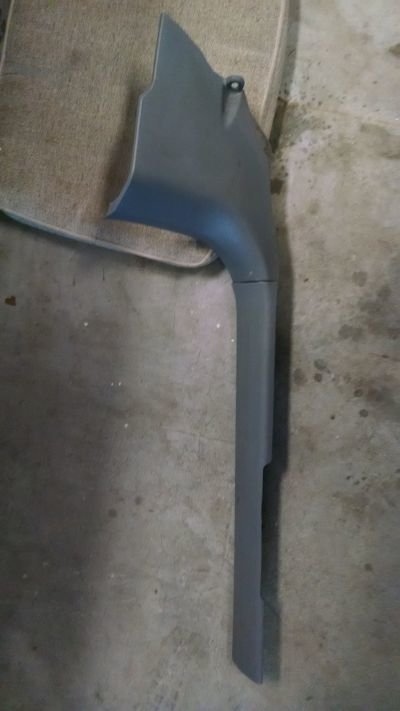

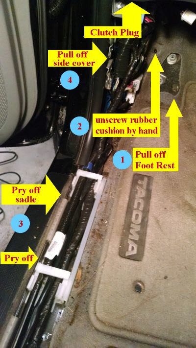

  15. Dec 28, 2018 at 8:27 AM
    #35
    gutsy
    Dec 15, 2018
    #275927
    84
    Dave
    Yardville, NJ
    I purchased the switch. But I couldn't locate the correct plug for the switch.
    It's a good time to vacuum out the floor board and corner near the foot rest - lots of dirt gets accumulated there!

  16. Dec 28, 2018 at 8:38 AM
    #36
    Muddinfun
    Apr 17, 2017
    #216500
    7,489
    That's not it. Should be a 2 wire connector. Blue/black and light green wires. Should be somewhere up in there near where the clutch switch goes.
  17. Dec 28, 2018 at 8:44 AM
    #37
    Muddinfun
    Apr 17, 2017
    #216500
    7,489
    BTW, to put the foot rest back, unscrew those white plastic blocks, snap them into the foot rest, and then just push the footrest back into place.

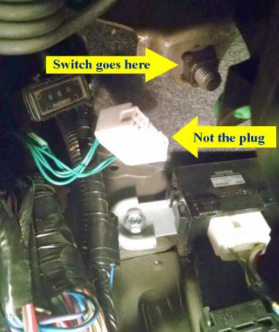

  20. Dec 29, 2018 at 10:55 AM
    #40
    gutsy
    Dec 15, 2018
    #275927
    84
    Dave
    Yardville, NJ
    I just took of the black tape off of this plug but it is not the correct plug. It's just 2 inches away from where the switch goes too .. so I'm stumped. It's too wide for the switch connection. I can't seem to find the plug. I looked everywhere around the switch location too. Does anyone have a pic of the plug and where it's located?
