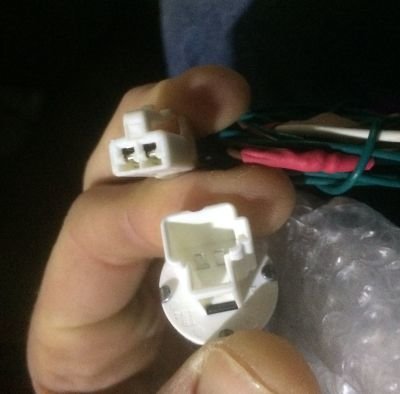

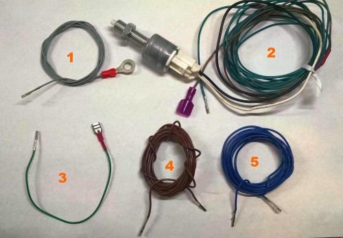

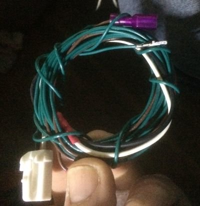

    So I decided to order a harness kit from a guy on eBay here. The harness has female spade connectors that goes to the ECU and to the lead at the power junction box. It cost me $40. I should get it later this week.
    He provided images of the harness kit and instructions which I cropped and re-sized below:
    #70
    Newfiebruh[OP] likes this.

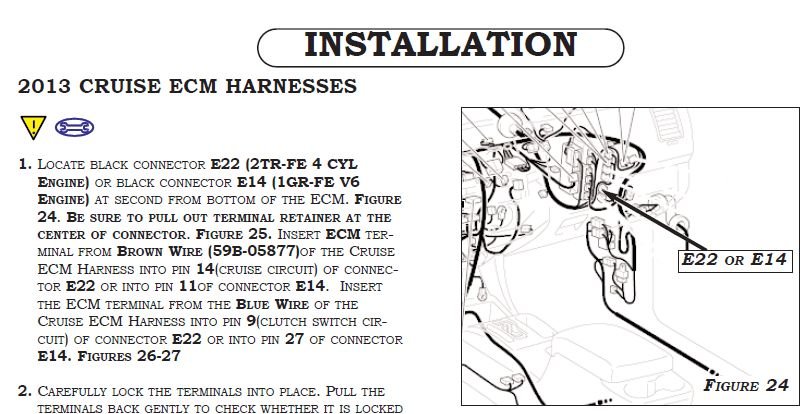

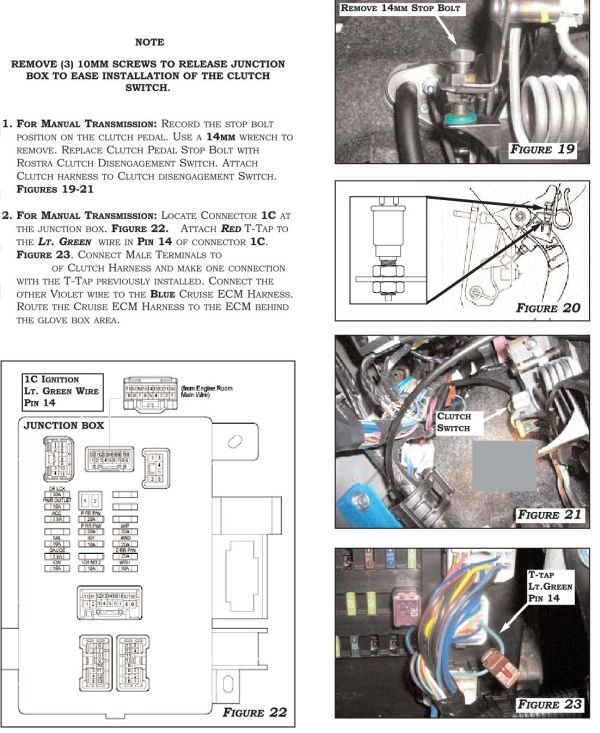

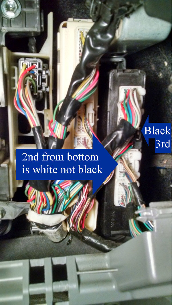

    OK .. I ordered and received the kit in the mail that I mentioned above (post 70). In short, it was just too complicated for me. I wasn't sure which of the 5 sets of wires included in the kit go to (see pic below). What I did want to do is ensure that I did not have a clutch plug already under my dash. So I decided to see if the wires were already connected to the harness plugs behind my steering wheel and on black plug (2nd from the bottom) on the ECM. So I did the following ...
    1. Downloaded the cruise wiring kit instructions (see attached form 5188f)
    (I already installed the cruise switch and proper wiring and ground in the steering wheel … so on to step 2)
    2. Located the BLACK connector (S8) behind the steering wheel and wires were ALREADY connected in pin 1 and 2.
    3. Removed the glove compartment cover and found the ECM and searched for a black connector E22 (per the diagram below, the ECM is on the right side - E22 is supposed to be 2nd from the bottom) to determine if wires are already connected to Pin 9 and Pin 14. The problem .. there is NO black connector located in the 2nd slot from the bottom of the ECM. The 2nd from the bottom connector is white. There is only 1 black connector on the ECM and it is the 3rd form the bottom on my 2010 Tacoma (see pic of my ECM below). I don't know if I am looking at the correct connector or not.
    At this point, I don't know what to do. Thanks in advance for any help anyone can provide.

  18. Jan 9, 2019 at 6:17 PM
    #78
    Muddinfun
    Muddinfun Well-Known Member
    Apr 17, 2017
    #216500
    7,489
    @caribe makaira is the local Tacoma electrical guy. Maybe he can point you in the right direction.
    Edit: I see 1 problem. You're using the '13 instructions. Your profile lists a '10.
    Farther down, there are instructions for '09-'12
    caribe makaira likes this.

    Added intermittent wipers, rear camera with Rear view mirror LED, remote door locks, Cruise control
    Hey Muddinfun .. Geez!!! Thanks for pointing that out!
    Well that explains it doesn't it. Ignore what I said above then (post 76).

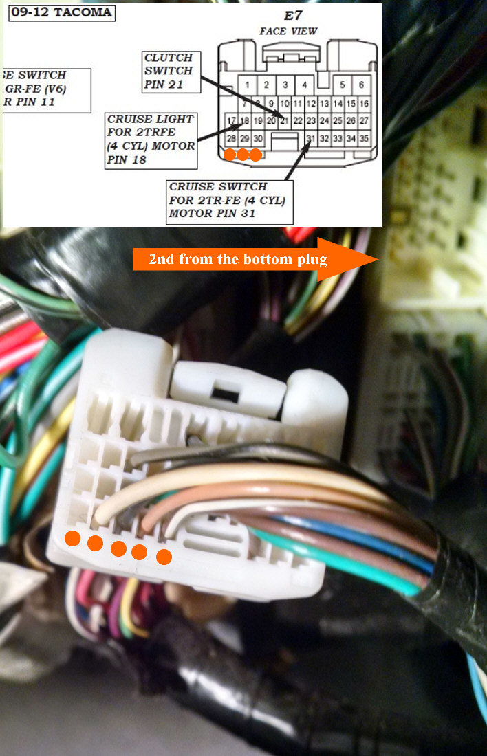

    So the 2nd plug from the bottom for my 4 cyl 2010 Taco is white. I'm attaching the correct images (below) for the 09-12 Tacoma.
    Now I have to check to see if there is a wire plugged into pin 21 for the clutch switch.
    Muddinfun likes this.
  20. Jan 10, 2019 at 1:38 PM
    #80
    gutsy
    gutsy Well-Known Member
    Dec 15, 2018
    #275927
    84
    Dave
    Yardville, NJ
    Black 2010, 4 Cyl Manual TRD
    OK .. so I removed the glove compartment door again removed the 2nd plug from the bottom of the ECM on my 2010 4cyl manual Taco, and it DOES NOT resemble the plug in the instructions. Do I have a 2010 Tacoma that no one else has? How can this be?
    See the picture of my plug - VS - the plug I cropped off the instructions. If you compare just the bottom left pin openings on my plug … I have 5 and the one in the instructions has just 3 (orange dots). So either I am looking at the wrong plug or this is an anomaly.
