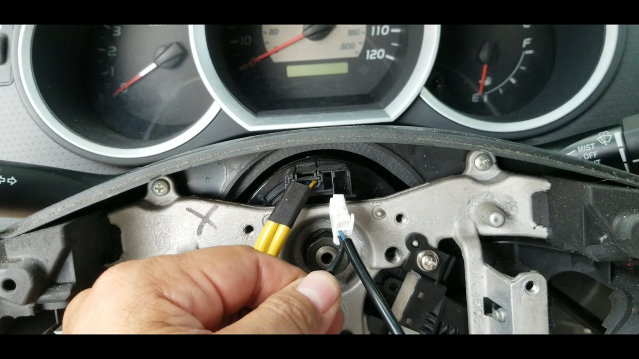

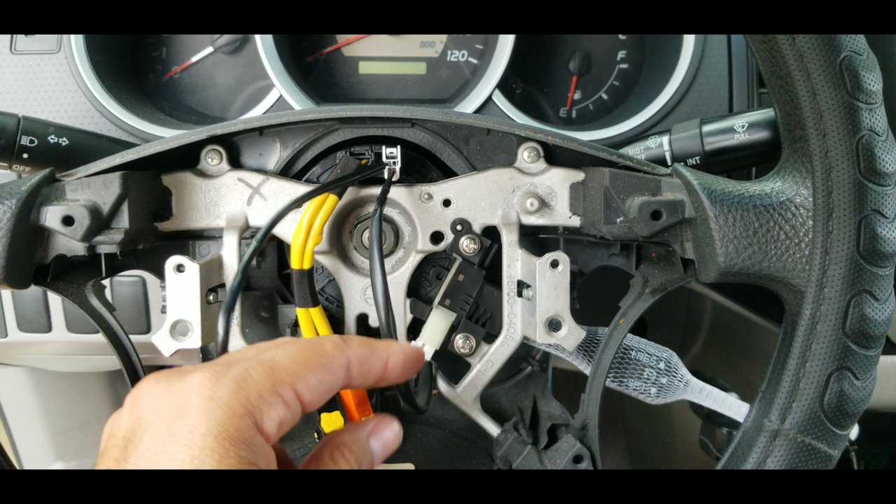

    Hey, I don't mean to "argue"
    I have an 07 base and did not have to swap the clock spring,
    the pic you posted shows the emply spot where the cruise would be plugged in,
    it would have 3 pins, the top one that connects to the back of the airbag ( this is the horn wire)
    and the other two bottom ones are for the cruise control.
    I have two videos showing how I installed CC to my base truck
    Project Lil Taco - YouTube
    this pic shows the female n male plugs
    Here is what it looks like once it's connected and the new cruise control bolted to the steering wheel :)

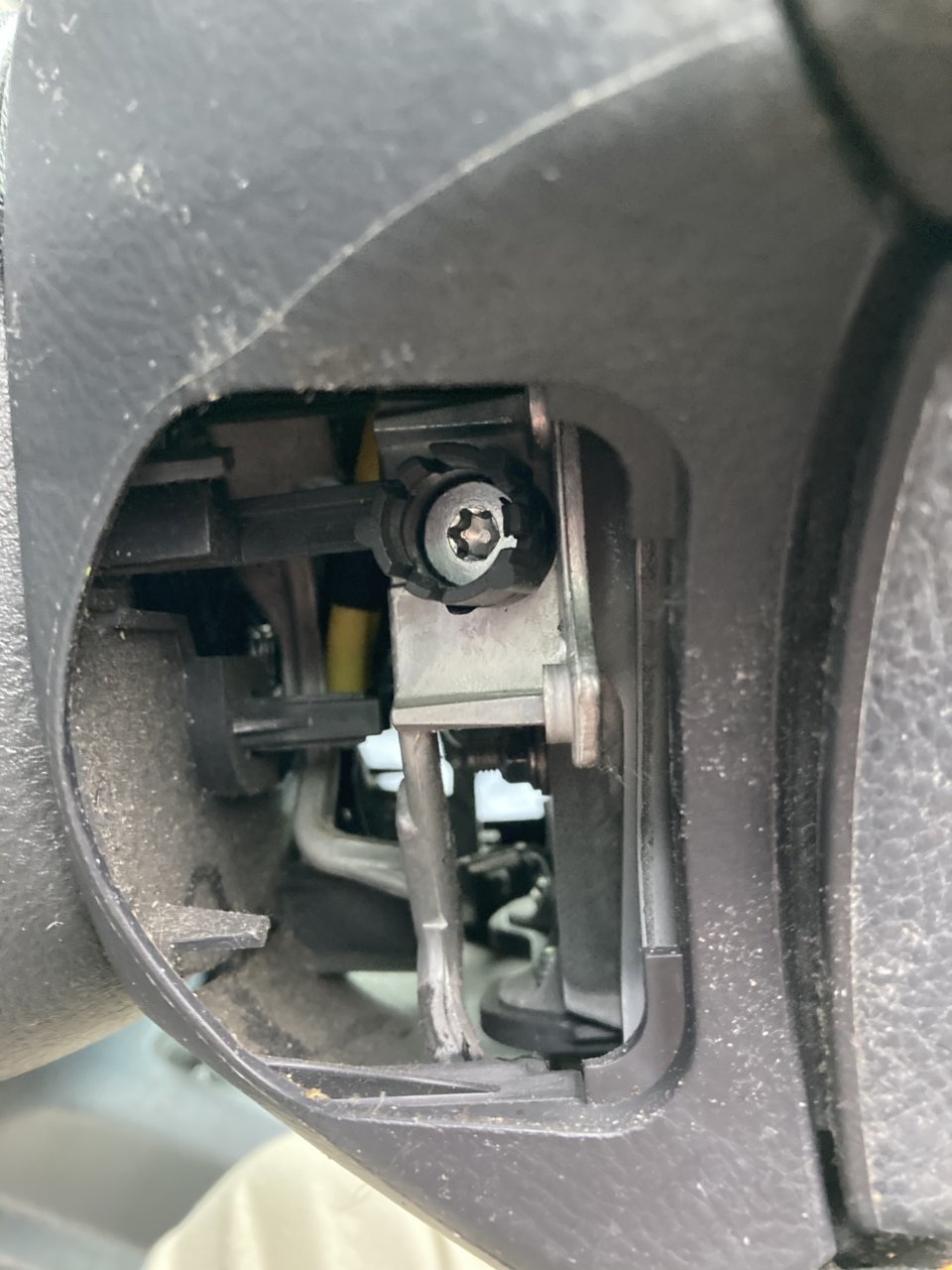

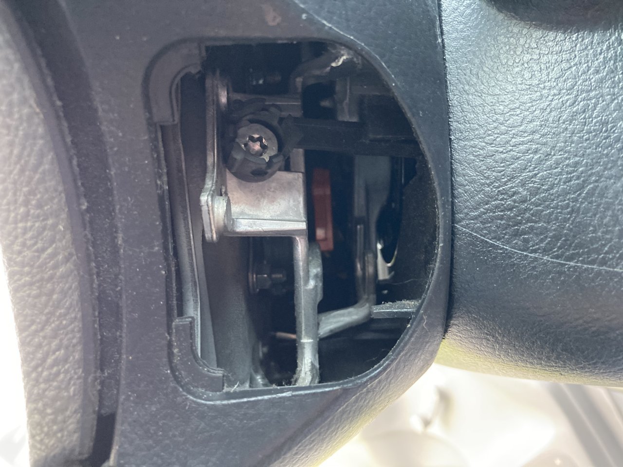

    Is this seriously all I have to do? Just this one wire and nothing needs to be done under the hood?
    Also, I can’t figure out how to get the airbag off; Is it those two star-shaped screws on either side?
    379044CD-42AB-4BE0-84EE-87D566E5DD13.jpg EE3C2B1D-66A4-436F-92DA-E16C1D3A5E6B.jpg
