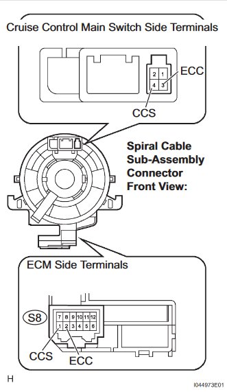

    A little more on the clockspring. Here is the necessary pins on the clockspring for CC:
    So 1 & 3 is needed on the 4 pin connector on the clock spring, with 1 & 2 on the S8 connector going out to the ECM/ground.

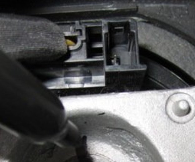

    Here is a closeup of the S8 connector which is marked (on Rockauto) as being for 'w/o':
    So it APPEARS to have the necessary S8 pins (the two that appears in the top of the image - it's upside down compared to the drawing). The problem is the selection of images don't show the 4 pin connector, BUT here is a closer view of the clockspring image I posted earlier in this thread:
    As you can see, it LOOKS like there is only one pin (#4?), so is missing the critical #3 pin.
    So it looks like if you have the 4pin like the pic immediately above, you DEFINITELY have to swap it out. If you have the necessary pins on the 4 pin and S8 side (and there is continuity between #4 of the 4pin and #1 of the S8 / #3 of the 4pin and #2 of the S8), you should be fine (though you may need some extra wiring for the dash light depending on the year/model?).
