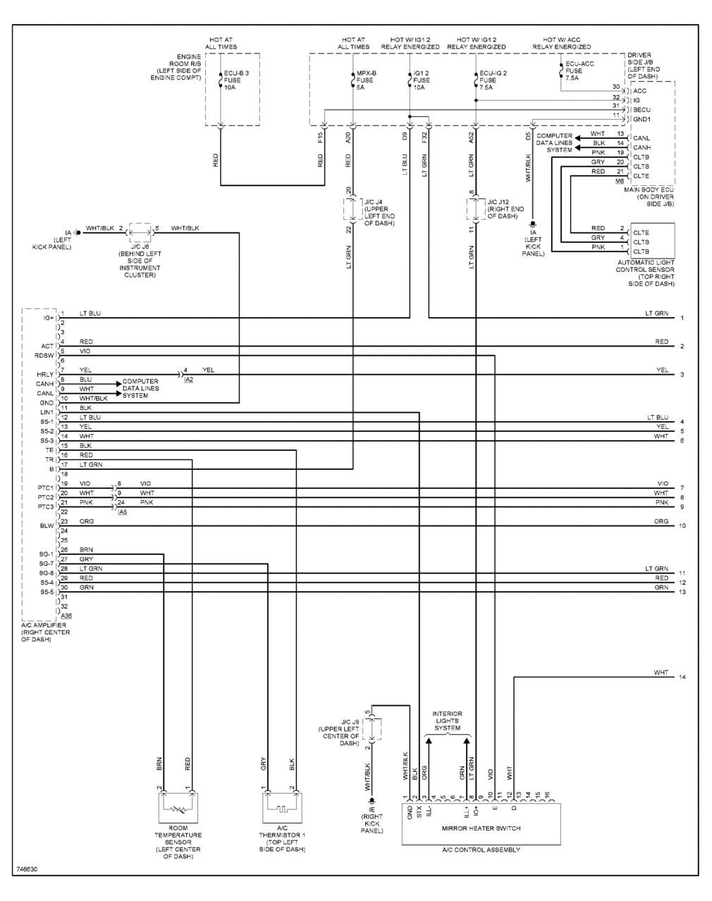

    If someone could get me wiring schematics or tell me where to get them I could try to figure this out. Although I’m only interested in making mine auto controlled.

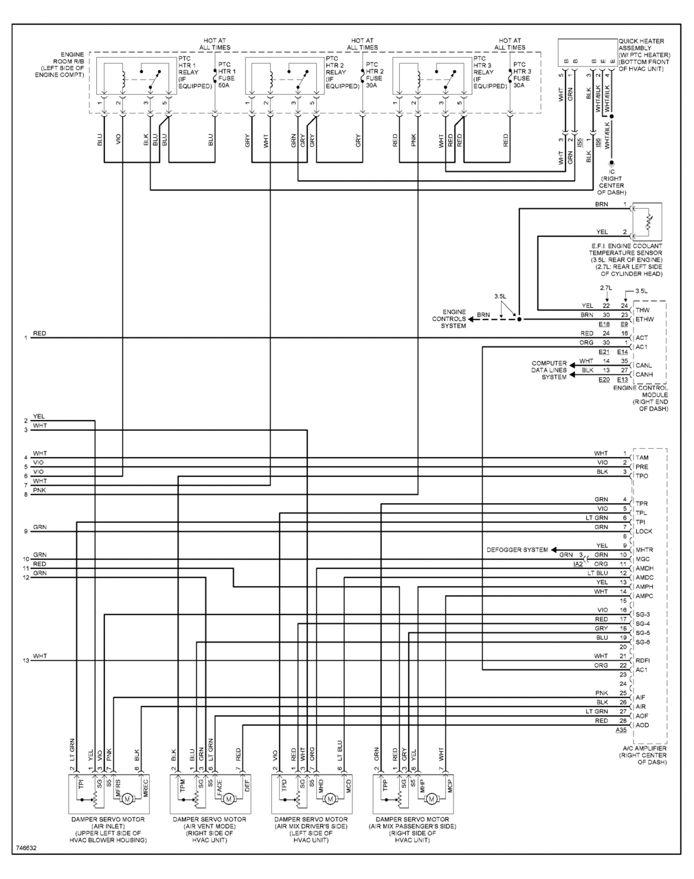

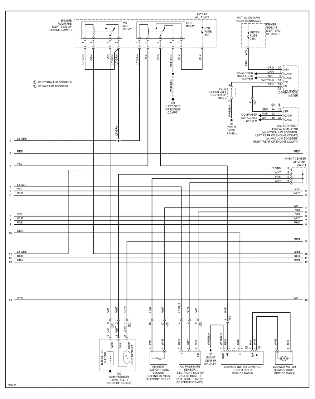

    You posted three wiring diagrams. Pretty sure that's how you summon caribe makaira haha.
