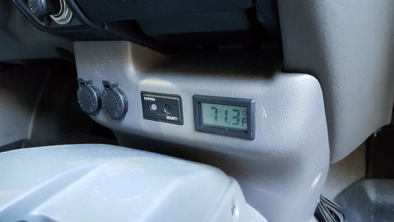

    I got the ambient temperature gage from Amazon and installed it in my 2WD PreRunner in the perfect spot . . .

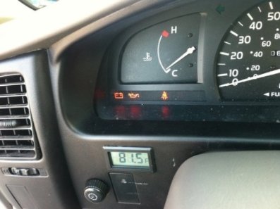

  9. Dec 5, 2016 at 7:08 AM
    #29
    nzbrock
    nzbrock Well-Known Member
    Jan 6, 2013
    #94572
    3,253
    Noah
    San Marcos, TX
    99 TRD Prerunner 3RZ
    SAW 2.0 Coilovers Wheeler's 5 Leaf + 3 AAL Bilstein 5100s LCE long tube header Flowmaster Delta 50 Muffler FJ Trail Team Wheels 4Runner overhead sunglass console 4Runner leather seats All LED lights Red/Clear Tail Light Tundra Brakes HID Projector Retrofits 4Runner Auto Up/Down Windows Bullet Liner Cargo tie down system E-locker axle swap w/4.56 Gears ARE MX Cap Prinsu Toprac Custom heated turn signal/puddle light mirrors Volant Intake Tube
    Did that fit perfectly or did you have to trim the opening?

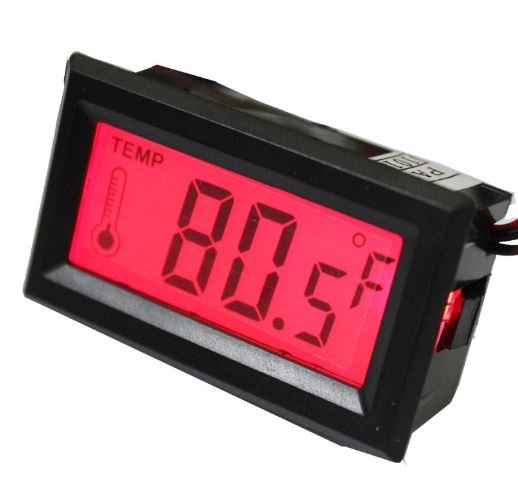

  10. Dec 5, 2016 at 8:02 AM
    #30
    prayzhm
    prayzhm Active Member
    Mar 1, 2016
    #179873
    40
    Bob
    2004 Tacoma Dbl Cab TRD
    I saw this also but wanted one that would illuminate in the dark.
  11. Dec 5, 2016 at 8:21 AM
    #31
    tahco_02
    tahco_02 Well-Known Member
    Dec 12, 2015
    #172053
    119
    SoCal
    2002 Black TRD PreRunner Access Cab 2WD
    Stage 1 Lift, 16x8 SCS SR8, 285/75-16 Dick Cepek Extreme Country, Ethan's Skid, Driving Lights Mod
    Had to Dremel trim a little.
  12. Dec 5, 2016 at 8:26 AM
    #32
    tahco_02
    Dec 12, 2015
    #172053
    119
    SoCal
    Red/Orange illumination would've been nice. But this particular one was the perfect size for the mounted location.
