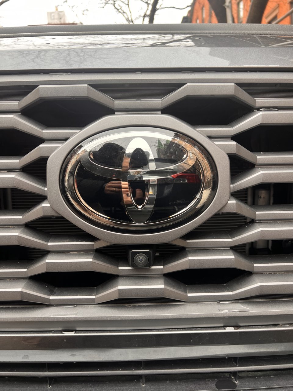

    I'm looking to install an oem trail edition grill on my 2023 trd or with factory front facing camera. I've been doing a bit of research here and all the threads Im finding only describe swapping an oem pro grill with an existing camera slot and bracket. It doesn't seem like anyone has fitted the oem camera into the trail edition grill yet.
    Wondering if anyone out there has made this swap and what you had to do to make it work.

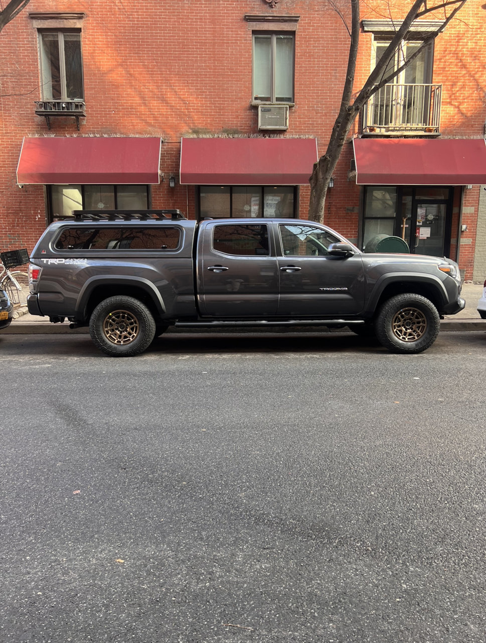

    Photo of truck attached for something to look at.

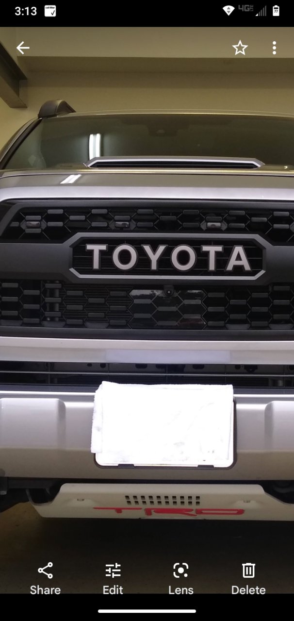

    Bilsteins 5100s on the top setting, 4runner Gray TRD Pro Sema wheels, 285/70/17 Toyo AT3s, Sumo Bump stops, TRD exhaust, ECGS Clamshell bushing, 1/4 shim for the lean and one inch rear block, OEM Pro grill and garnish OEM TRD Skid plate, TRD CAI, Demon Brackets, Rigid Industries Pro fog lights, OEM Trail Rails sidebars, Diode Dynamics LED SL1 high and low beam lights, OEM Roof racks, Clazzio leather heated seats, Remote Start, TRD Pro shift knob, tinted windows, Rockford Fosgate 4 channel amp for the headunit and sub and amp combo, OEM Puddle lights, OEM tailgate lock, OEM bed mat, LED interior lights, OEM blackout kit for letters, JLT catch can, upgraded 27F toyota True Start battery, Vleds led tail light kit with Pro tail lights, OEM Rave4 side mirrors with convex spotters,just to name a few mods.
    Screenshot_20230131-151318.jpg I got a Germes plug and play front camera control system with a Natika camera. It was easy to install and I mounted the camera dead center of the TSS on my Pro grill at the top. Looks OEM, awesome clarity and you use the steering wheel controls. The front cam comes on in drive just like the reverse cam does. Plus you can drive down the road and use the cams and toggle front to rear with the up/down to switch cams with the steering wheel controls.

    I’m trying to move the factory installed front camera on my off road grill over to an oem trail edition grill that I just purchased.

    The truck is a 2023 offroad with advanced tech package, so all the cameras already exist. Just trying to move the front camera from one grill to the other. Trail edition grills don’t have an oem camera spot on them- trying to find a workaround for that.

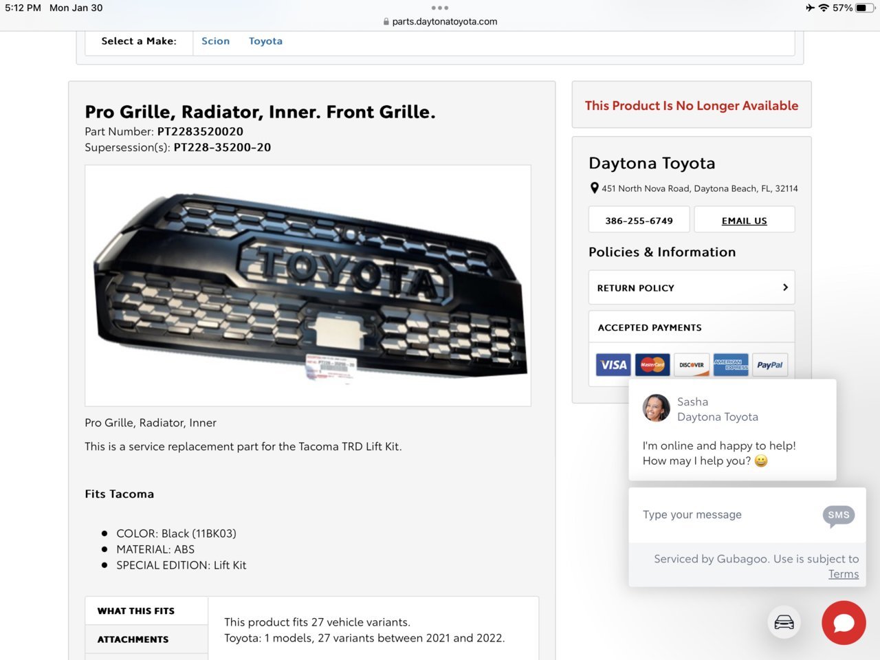

    The issue is that bracket - part number PT595-35210 is for a pro grill with the camera cutout in the grill

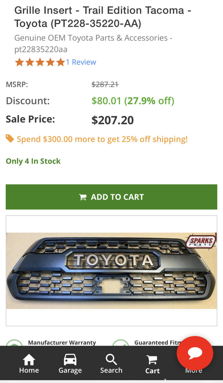

    No camera cutout for the trail edition grill:
