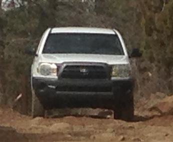

    I am looking to add fog lights to my 2008 tacoma. I am not sure what all I need to make them work with the existing holes in the front bumper.

    I wired mine with a relay tapped off of the high beam circuit. Now they come on automatically with the high beams.

    I have a set off of my truck they are OEM foglight, but i do not have the wiring harness.

    Don't need it. Two ground wires to the frame and one linked hot wire from your relay to both lights. run the relay off of your high beams, the battery and ground.
