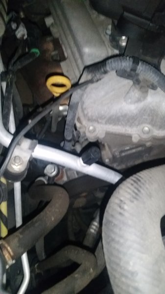

    My ac is low on Freon. Does any one know where the low side fill port is? I can probably find it but right now I am on crutches. I will probably get neighbor to help me. If so I do not want to have to spend more time than needed.

    Here ya go, black cap next to oil dip stick on the silver piping.

    The bigger of the 2 caps is where you add refigerent. The refill kits only come with that size coupler.
    How long has the system been low? If over 2 years, better find a pro that can repair the leak and recharge system to proper capacity.
