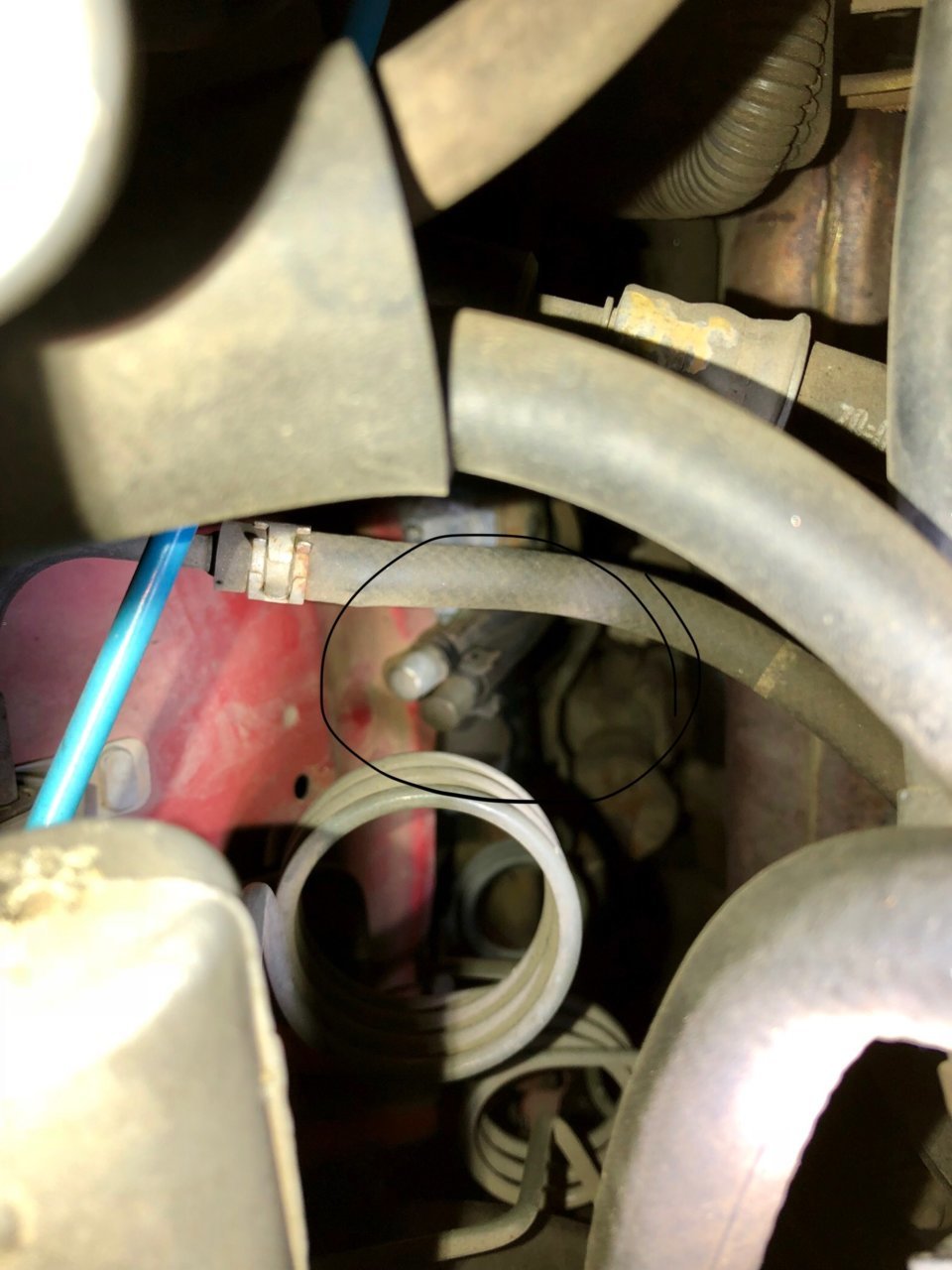

    My fill plug is toast, but I can get the drain plug off. I have read about adding oil through the breather, but there are two under the hood and i can’t trace which is the diff. Please help. The truck is an 03 Tacoma with ADD and rear locker. This is for the front diff. Thanks!D159462A-C19E-4087-81B2-B01810481342.jpg

    Yeah, I know that’s the best fix, but I’m in a time crunch, and my welding skills are non existent. I had to edit my first post, I can’t see which breather is which. I was hoping someone who may have extended theirs, knows for sure. I think I might be able to drain the old fluid and then jack up the truck enough to use the drain as the fill. Anyone have thoughts on that approach?

    That line is about 1/4 - 3/8 inch. Adding 75-90 (?) gear oil into the dif will take forever. The back pressure will not let you pour the oil in.

    Does the breather thread into the differential like on second gens? If it does unscrew the breather from the case and fill through the hole rather than trying to pour heavy weight oil down a couple feet of narrow diameter tubing.

    I can’t really see how it connects. I started this part of the project at 2AM and I was seeing double by that point. I had read about other people using the breather, so I am considering my options. With the limited space in front of the fill hole to work with, I’m leaning toward jacking the truck up and using the drain. Might work?

    If like the Tundra, I believe the two in the front are for the front diff and the transfer case. The diff breather in the back is a stubby one right on top the left side of the pumpkin as you look at it from the back.
    Can you trace the transfer case?

    Weejub, I’ll try and trace the one from the transfer case, to see if that’s it. Like others have said, filling through the breather might be slow, or impossible. However, I can see taking 4 hours of driving around for parts and cussing at the bolt and still not having it break loose. I can drink a lot of beer baby sitting a slow fill through a breather, if possible.
