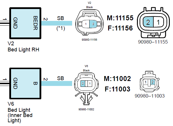

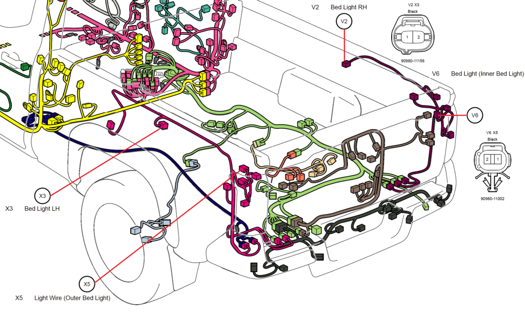

    Have you looked for the connectors? Between the fender and the bed, both sides. The bed lights are 2 types, one is interior the other exterior (fender top edge with bed).

    OP, have you checked your Taco for the connectors?

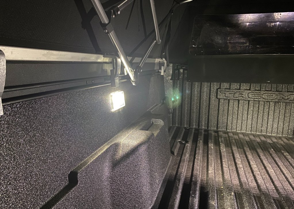

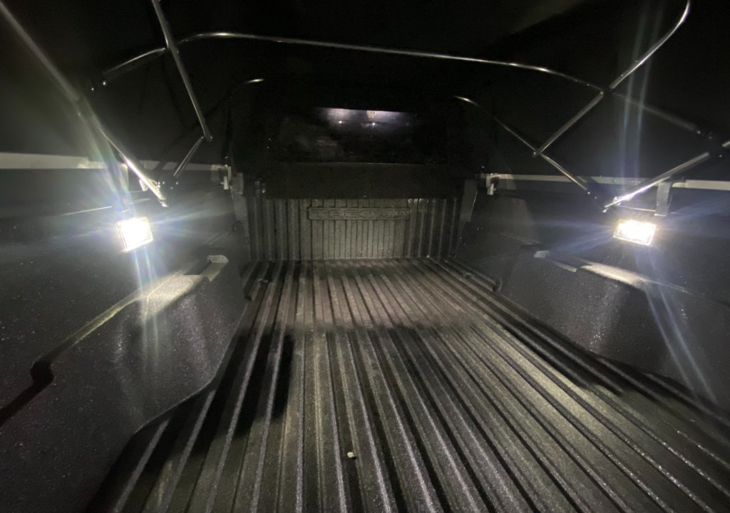

    I bought these for a couple of dark closets in the house and have been impressed enough that I bought two more for the bed. Stick a couple magnets on each side, attach the lights and when the gate is open, they come on. When the battery gets low, I take them in the house, or hook up a small battery pack and recharge them.

    I have looked, but I can't find any extra wiring between the fender and the bed. If it is there, I can't see it.
