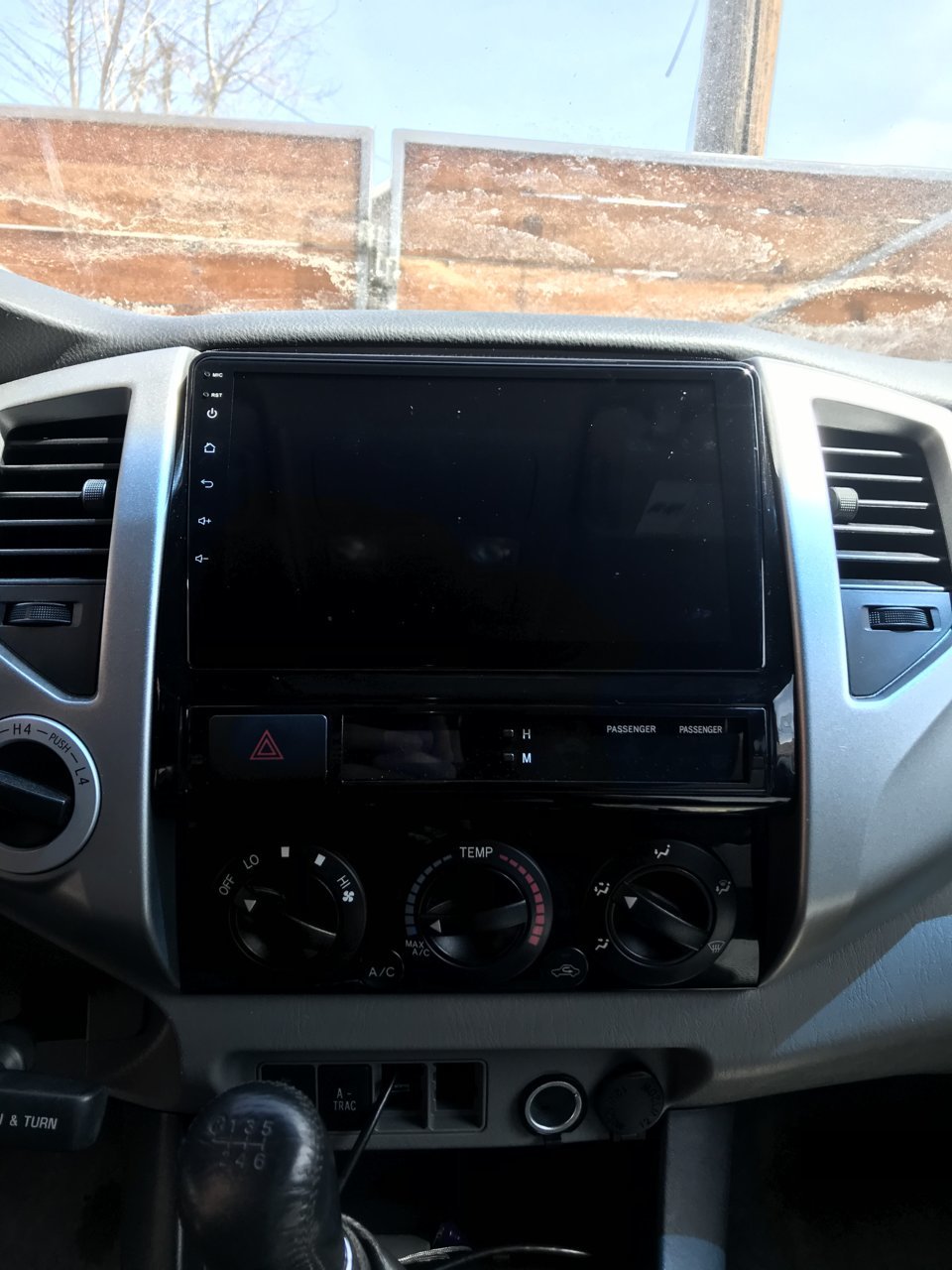

    I put a Dadaita Android head unit in my 2012. Has a 9” screen, operates just like an Android tablet, and comes plug and play with everything you need. Everything fits really nice and it looks almost factory, but sounds noticeably better than stock. Steering wheel controls work fine too. If you want the backup cam to be rerouted to the HU, you need to do some splicing and add a voltage regulator, but it worked for me. I think I payed $470 for it with apple CarPlay. There are a couple threads on here about it too.
    https://www.amazon.com/dp/B07Z96B5RB/ref=cm_sw_r_cp_api_i_vfWNEb4T6F06Y
    Crappy photo, but you get the idea.

    Think that HU would work in my 06 with JBL system? Awesome looking setup for sure. Thanks for sharing.

    They have different versions of it, so as long as you are paying attention to the model years and compatibility when ordering, it will work just fine. I think the only real difference is the wire harnesses.
