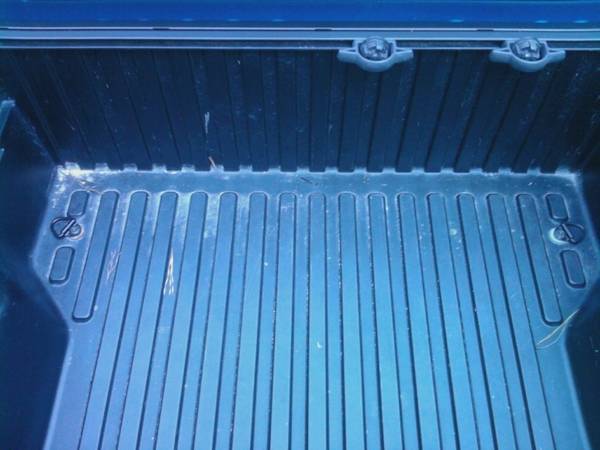

    I'm sure whatever I'm about to asked has been asked a million times, but please bear with me.
    So I have a short bed tacoma and it has two D-rings at the rear end of the bed. A bit of a weird spot to put em if you ask me. But anyways. If you check the pic below there are also this bolts on the bed.
    Basically what I wanna do is unscrew those bolts (like on the right of the above pic) and add additional D-rings like. I have about 4 of these bolts.
    Now I have two questions.
    1) How do I unscrew these guys? I got a torx bit wrench of mine and I couldn't get em to budge with all my fuckin strength. They are really tight! I'm guessing I'll need power or air tools? Is that that the only way?
    2) Where can I get D-rings that will fit on those spots?
    Thanks!!

    I just installed a bed buddy - better solution IMHO.
    For around $100, you get bed reinforcement plus three more eye bolts.
    dp

    I bought OEM D-rings, drilled out 2 of the water drain holes in the front of the bed and bolted them down to that. I used a backer plate on the bottom side of the bed, so far so good!

    I wanted them as far forward as I could get them. Perfect for securing a motorcycle in the bed where you want the straps to hold the front tire tight against the front of the bed.

    I have a toolbox mounted immediately behind the cab, so I'm planning to drill a couple holes for two additional D-rings in my bed just in front of the wheel well bumps on either side.

    I did this mod. All of my bed bolts were loose ! I mean like hand tight.

    I did mine but i didnt order the toyota ones and made it closer to the corner of the bed. I use mine all the time. Got mine from King bolt for 3 buck for both anchors.
