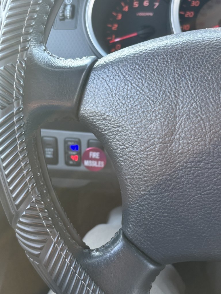

    I hard wired it from keyed power behind the dash.
    I was thinking of removing the dash light rheostat and mounting it up higher but I have it down low so I can see it through the steering wheel.
    here’s a morning pic. The blue looks blurry but it’s actually really bright.

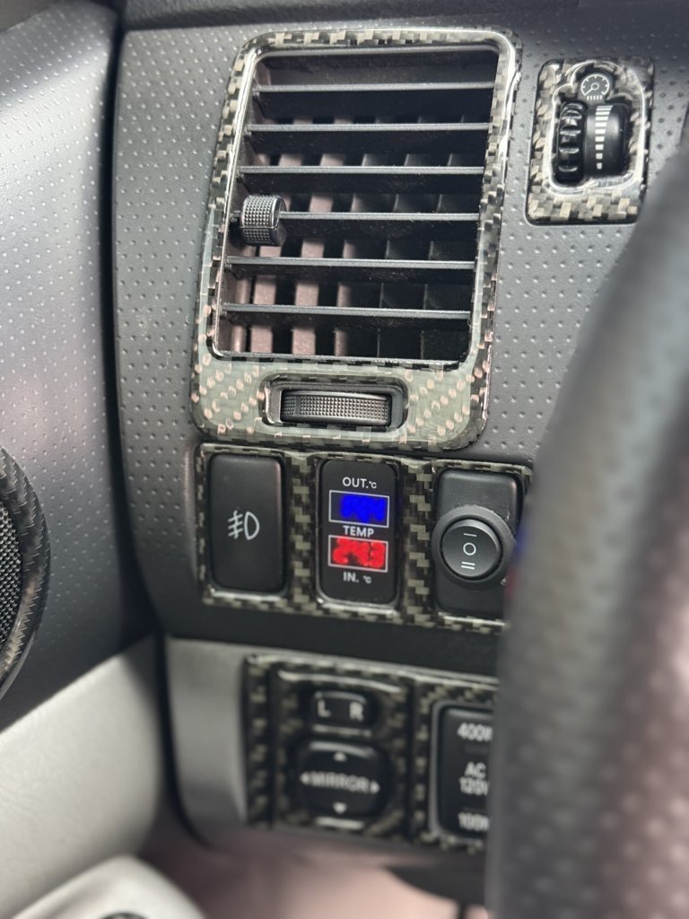

    Mine is in the lower bank of switches, but it's hard to see there behind the steering wheel. I will likely move it to where you installed it.

    My view through the steering wheel spokes in the lower position. It’s not that dim in person
    I was thinking of replacing the dash light rheostat with the temp gauge so it’s up higher

    I have room on my upper bank of switches so I'll probably move mine there. It's nice to have the temp gauge, but I can't see it when I'm driving straight unless I sit up and look over the steering wheel. Not a giant inconvenience by any means, but if I have the option to move it up, I mays well set it up so it works for me.
    Is the rheostat the same size button?
