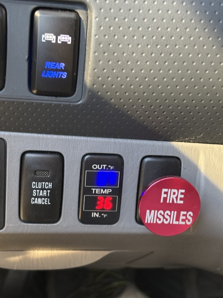

    it’s the same size. I have to figure out a way to bypass the switch and maybe hard wire? to eliminate it so I can use that space. Still a bit hidden by the rim of the steering wheel at some angles but at least you’ll be looking up high and not down low away from the road when checking the temp.

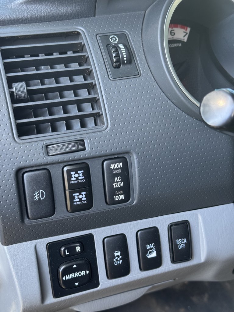

    Here’s my 2014 OR.
    My front/rear locker switch has replaced the factory rear locker switch.

    I never considered changing the rheostat… but I have never dimmer it in years of ownership. Might be worth putting the temp in that location and just unhooking the rheostat.

    This blank would be a good spot too, but a bit more wiring… so not ideal.

    I did notice there were two different styles of gauges - type A & B. Wondering if that's why I had a bitch of a time fitting it on the panel.

    So I haven't committed to pushing the temp gauge into the dash all the way yet. It's such a tight fit and I don't want to break anything. Did you have fit issues with yours or did it pop right in?

    IIRC it was “snug” but went in fine without having to trim anything. If you got the wrong size it would be visibly wider/shorter than the opening. Hopefully you ordered the “type B” size for the upper location, “type A” is the lower panel by the shifter
    Do you have a loose switch blank to match up with?

    Yeah - it's the correct style for sure, but I'm feeling a ton of resistance towards the end - it's still sticking out maybe 1/4", and like I said I just don't want to break anything! Two of the prongs on the temp gauge have actually broken trying to push it in all the way.

    Took some finagling but I got it in.
    I will say, in my opinion, the blue is hard to see when the sun is hitting it, but still better than no thermometer.

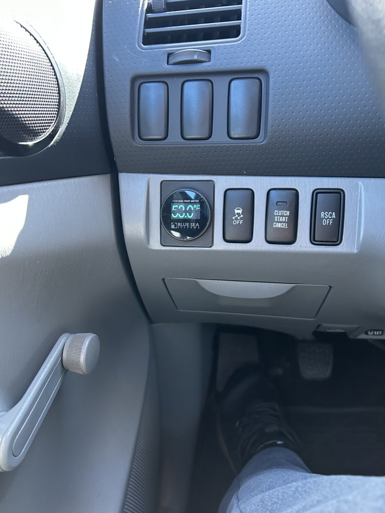

    Figured I’d chime in for us regular cab owners.
    im a big fan of marine grade electrical components (blue sea systems, sea dog, isotherm, etc…)
    Us reg cabbers don’t have power mirrors so I used that blank to mount a blue sea systems mini oled temp gauge. Can also swap out one of the two 12v sockets if you don’t have the power mirror blank.
    Ran a fuse jumper from the panel right behind the gauge. The power draw is negligible so this won’t do any harm running off the jumper.
    Pic doesn’t come out showing the temp clear for some reason.

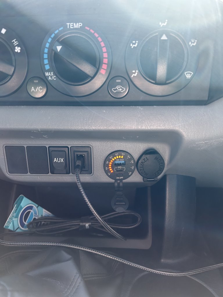

    That’s a sea dog usb/usbc/volt meter that I swapped in for one of the cig outlets.
