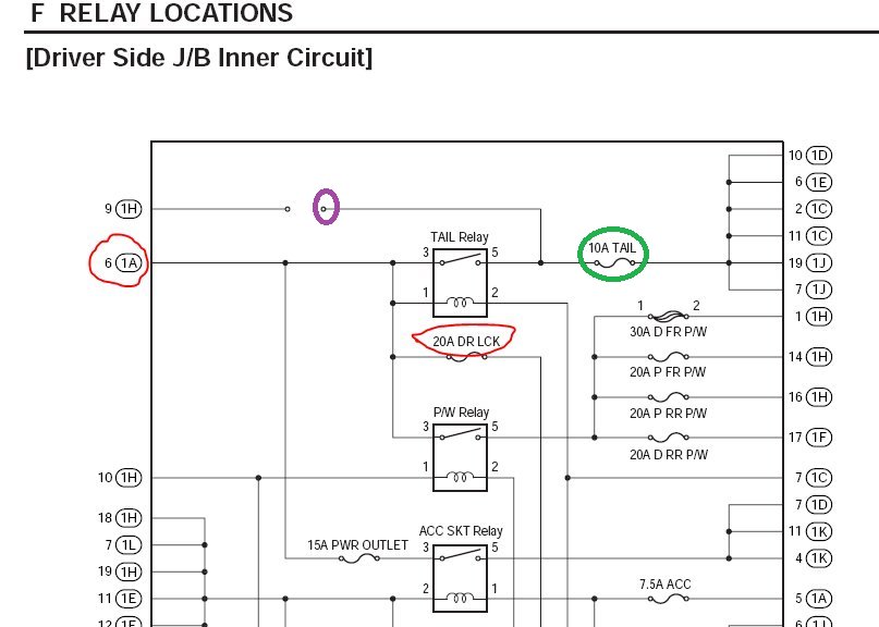

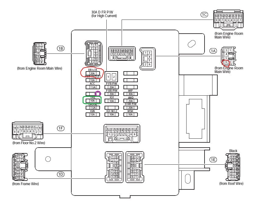

    Thanks go to @ProfHobbit. I'm thinking to add power door locks to my base Tacoma. I'm ignorant about wire things. So here comes a couple of questions while waiting for the parts.
    1. Power source. Either way below should be ok, right?
    ---add a fuse to "DR LCK 20A".
    ---tap to "1A" 6 based on J/B inner circuit.

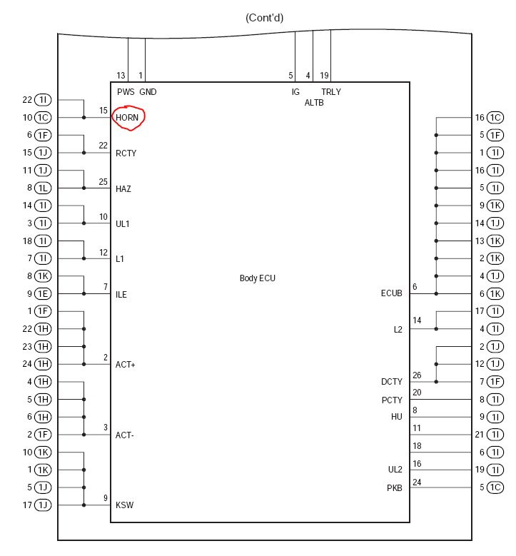

    2. If I want the honk on lock, I just need to tap to "1I" 22 and "1C" 10? The kit I bought has two leads for parking light. Can I use them for horn? If not, where are the parking lights numbers on the figure below?
    Sorry for the stupid questions. Thanks in advance

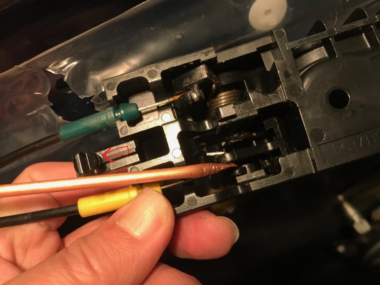

    remove the door panel. Then, I slide in a flat head screwdriver to push the tab in the direction shown in the arrow in the pic below to pull off the lock unit. Then put the tube in

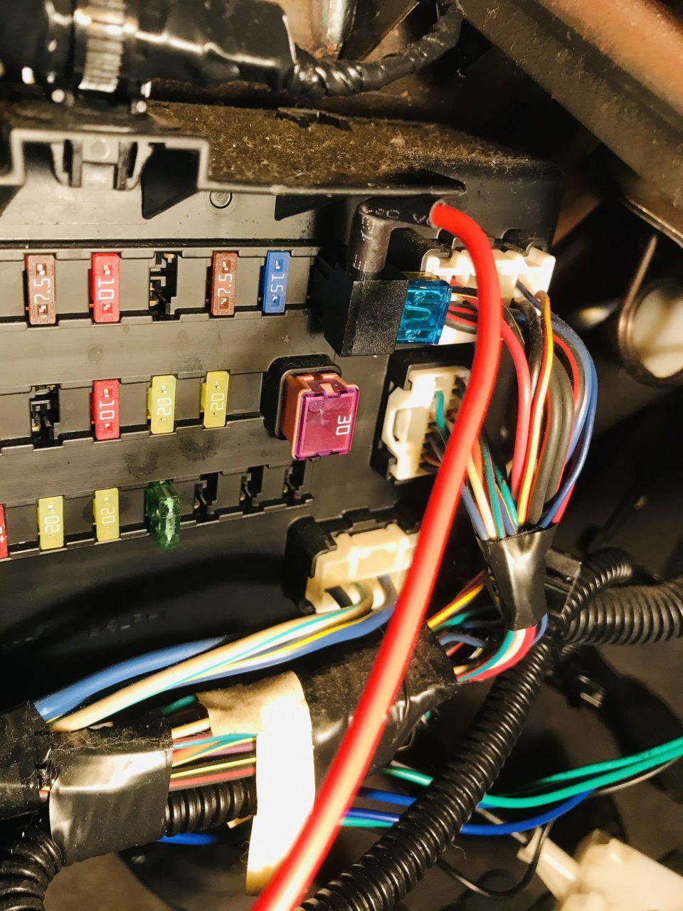

    Power source: I used "DRLOCK (20A)" indicated in the 1st post.

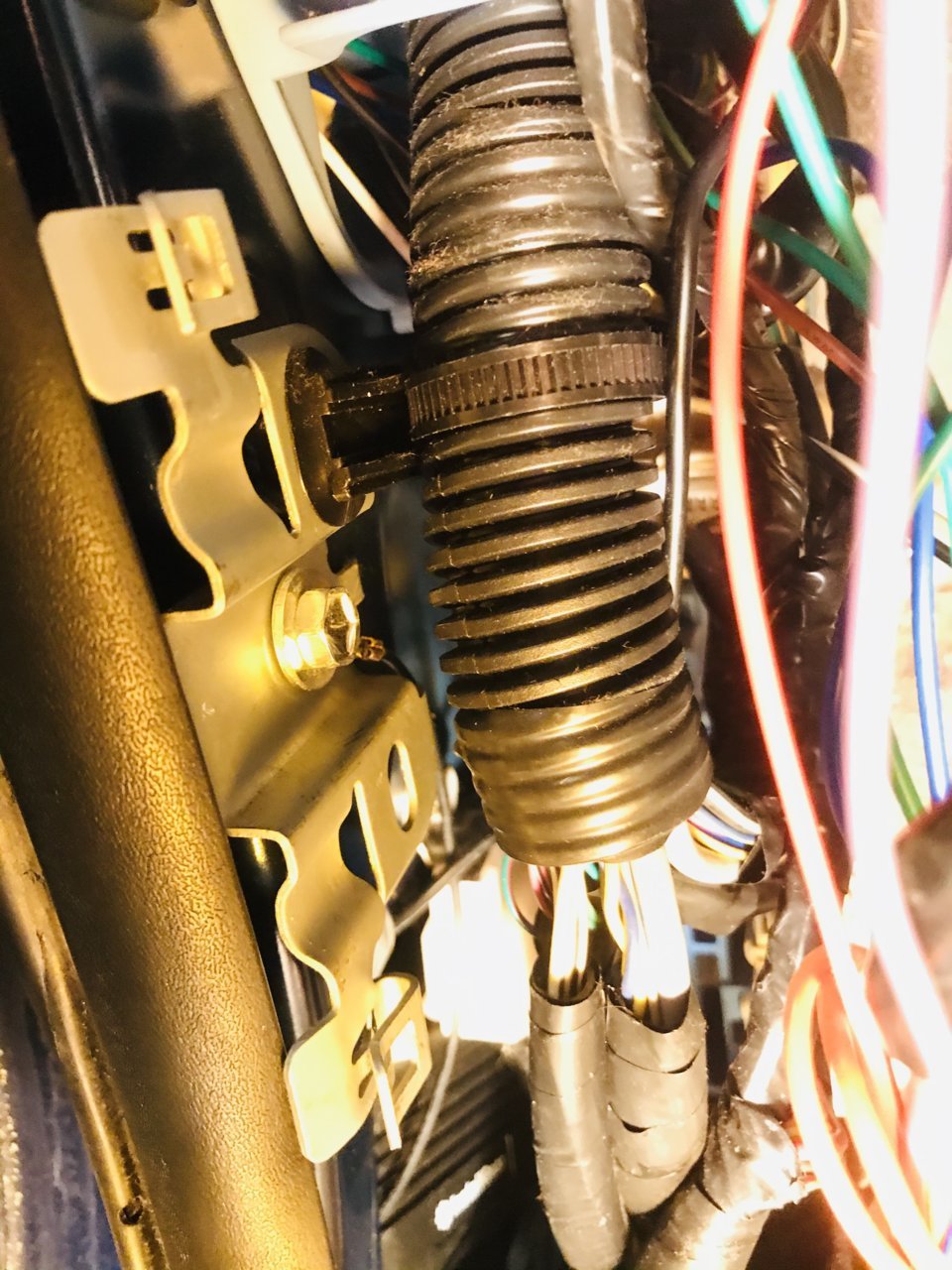

    Ground: I used the kick plate bracket bolt.

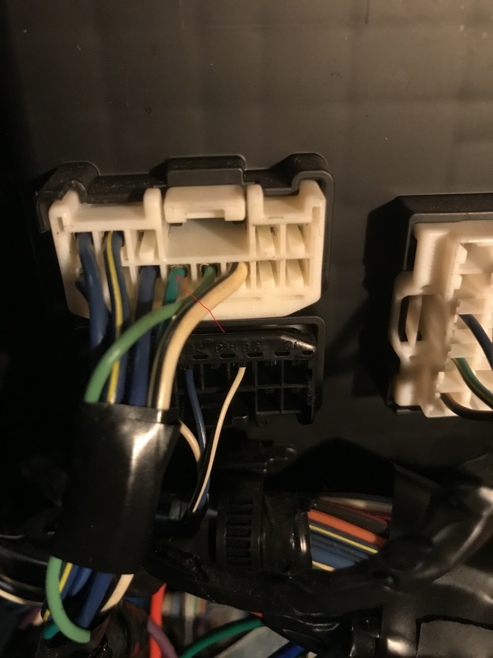

    I changed my mind. Instead of using the honk, I decided to activate the parking light.
    Parking light positive is the No. 10 in "1D" (the first post)

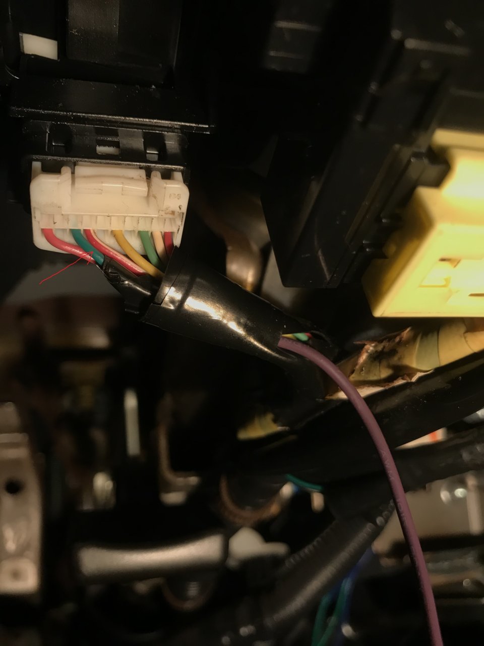

    39
    Parking light negative is in the turn signal harness on the steering column.
