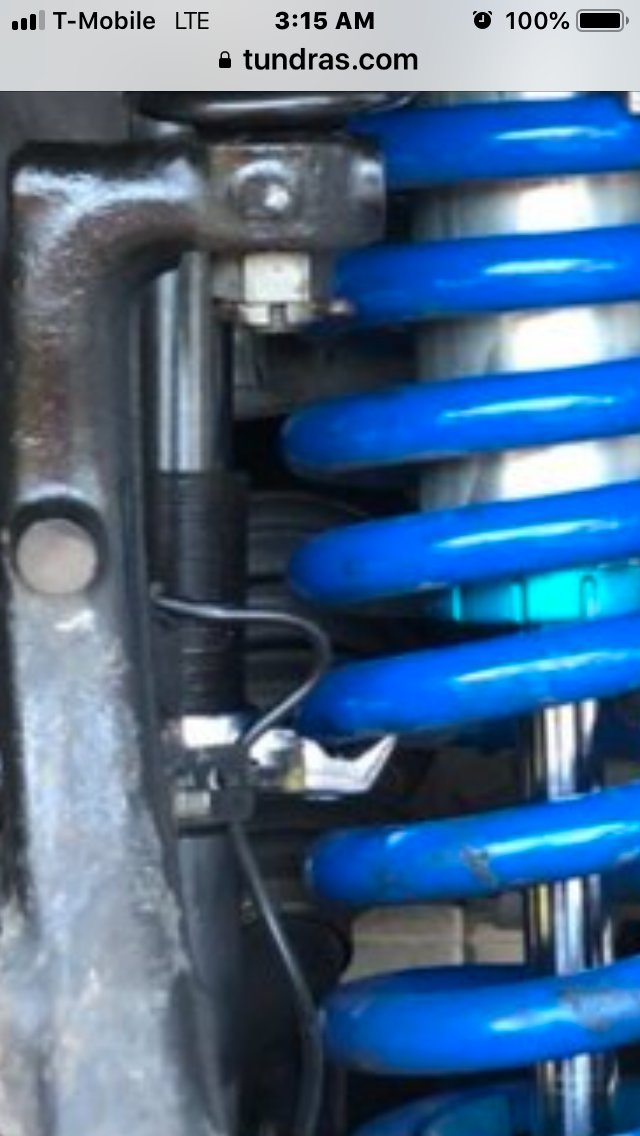

    I have seen people use certain spring compressors, and this is why removing the shock completely is best practices.
    This is from a Tundra.
    Notice the lower clamp.
    @AccuTune Offroad is a great resource for advice and tuning. I’m glad to use their site for tuning and what not.
