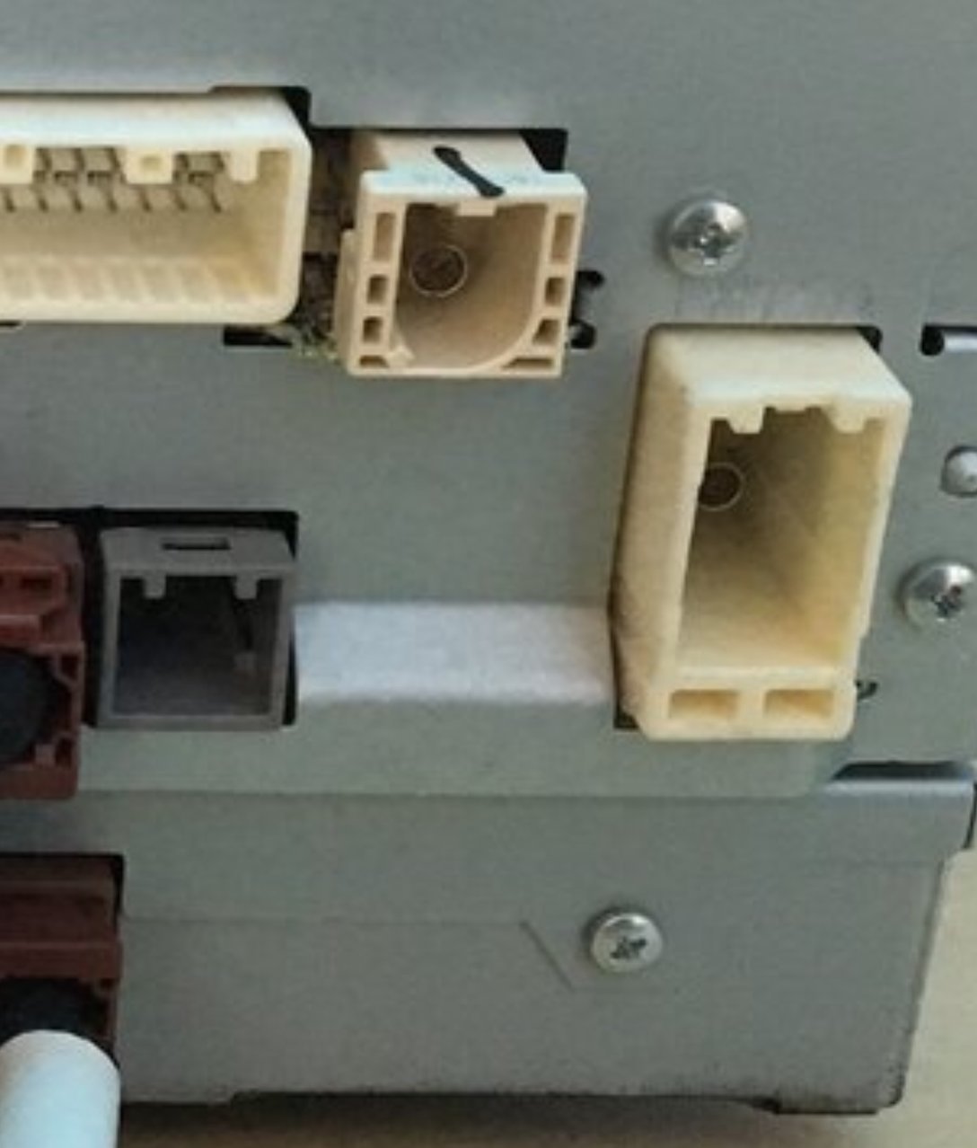

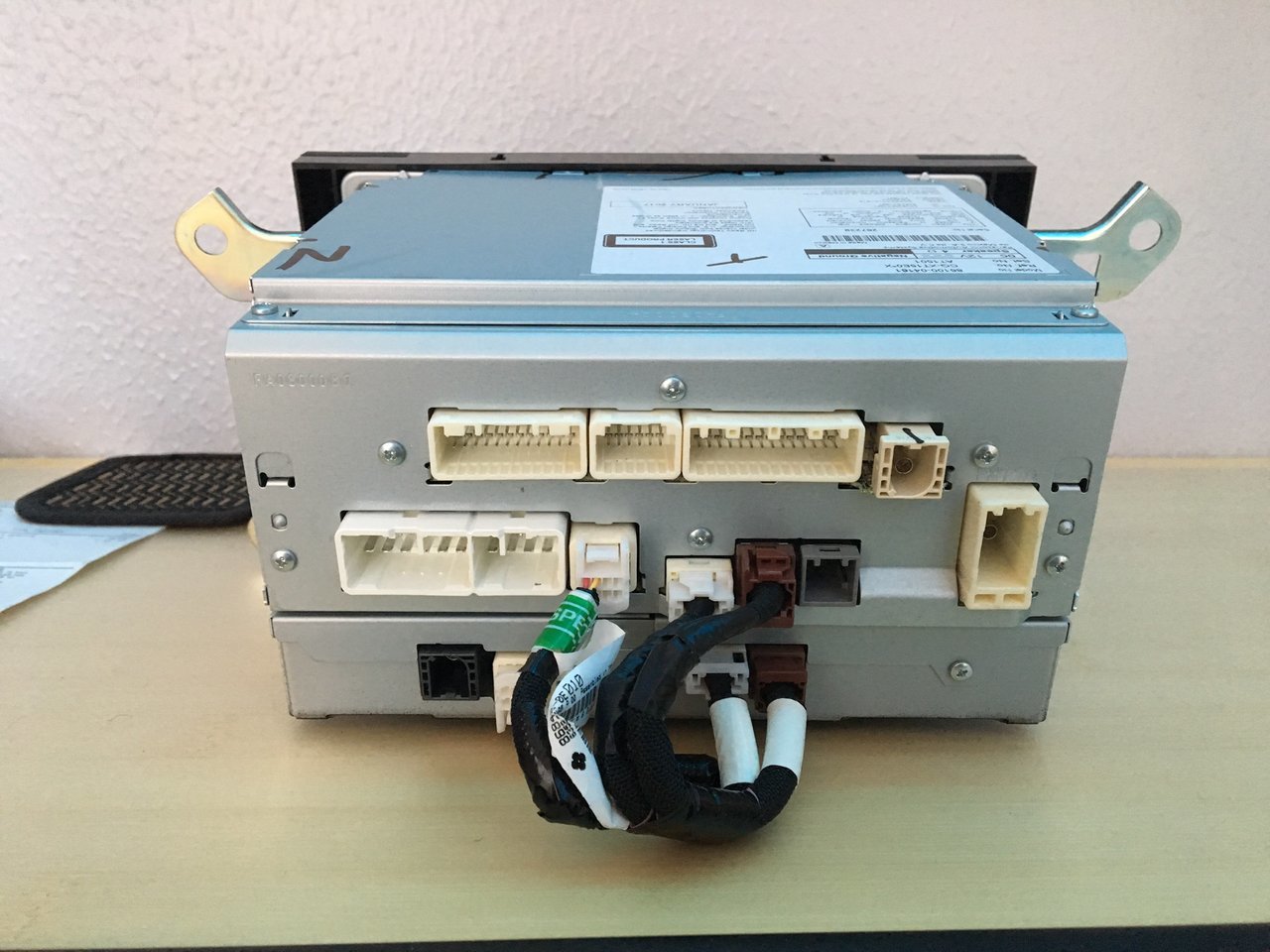

    As your looking at the back of your stereo, it’s all the way to the right. It’s the rectangular plug. It’s definitely tricky wiring it but once you’re under there you’ll figure it out

    Sorry I didn’t get back to you I just saw this post, you didn’t quote my post or flagged my name, so it didn’t alert me to what you asked. Anyway, I just ran the cable down through my back window between the backseats and under them, under the rear floormat between the passenger seat and the center console, then I tucked the cable along the plastic edge of the center console and then ran it up along the firewall behind the vents. If you look down from behind the head unit space, there’s a space towards the driver’s side that you can run the cable up to the head unit.
