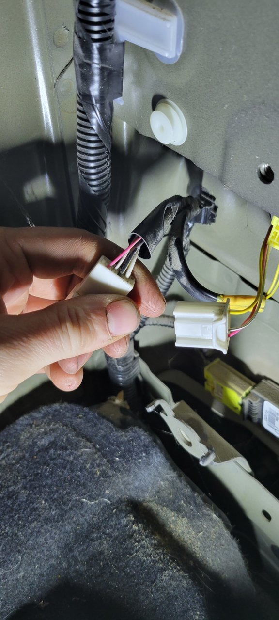

    I opened that up but the wires to that connector are so short there's no way I could work with them in that little space. I couldn't get the panel off, just opened from the weather seal side.

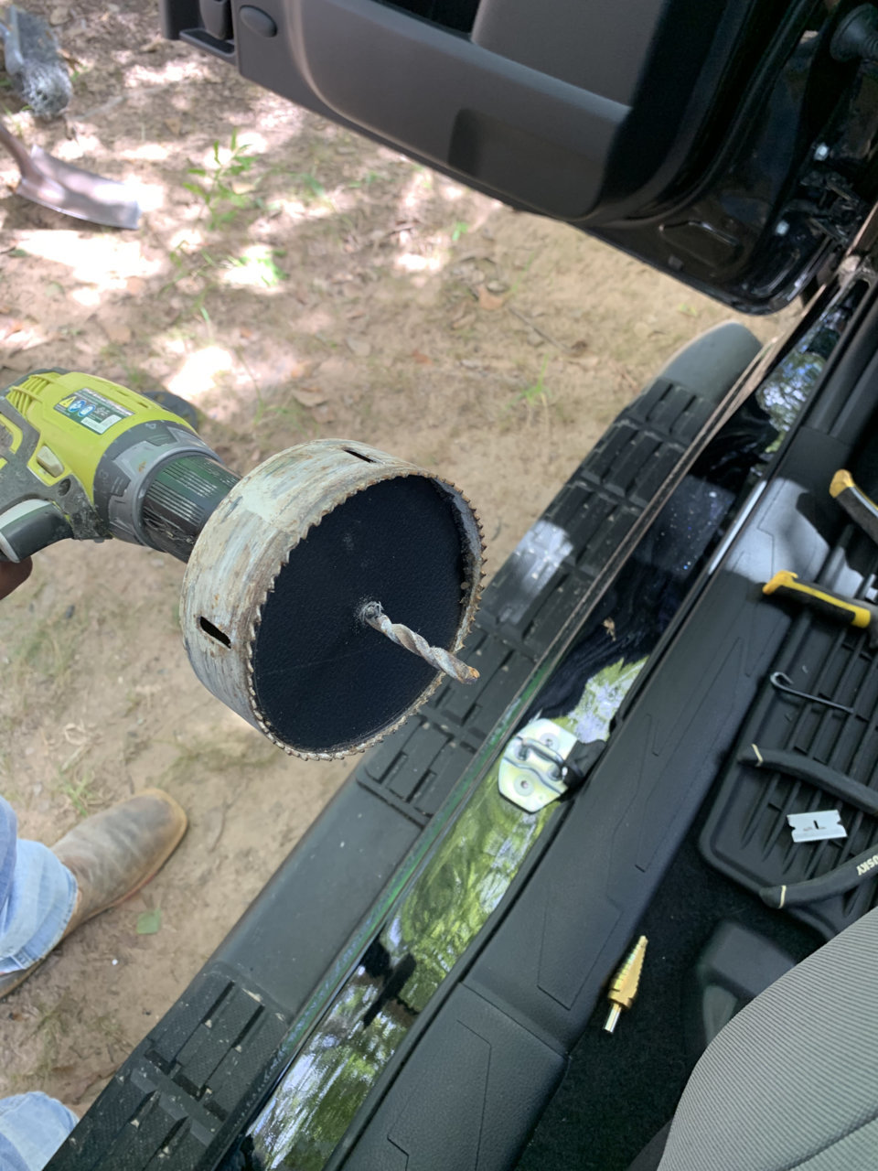

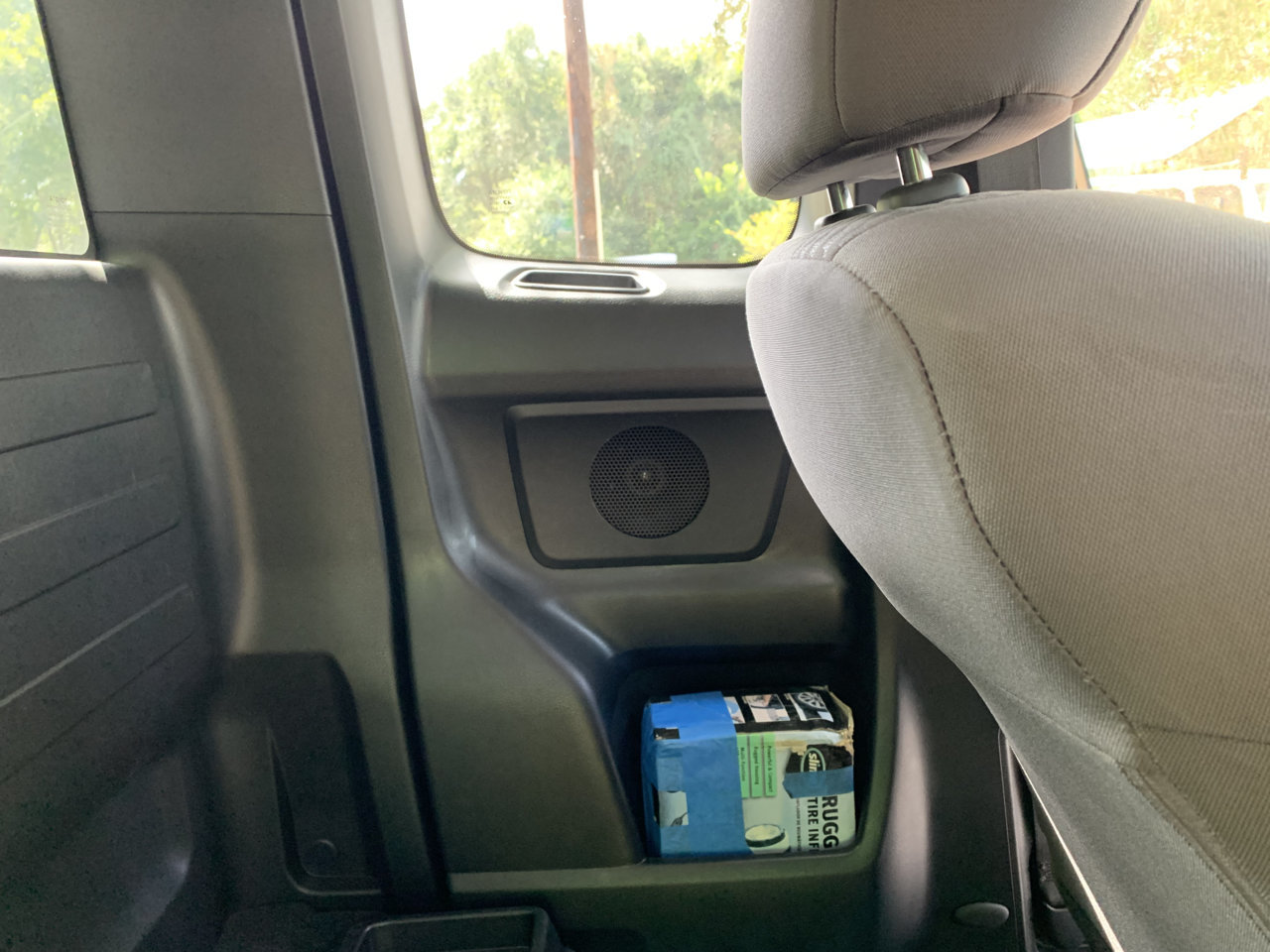

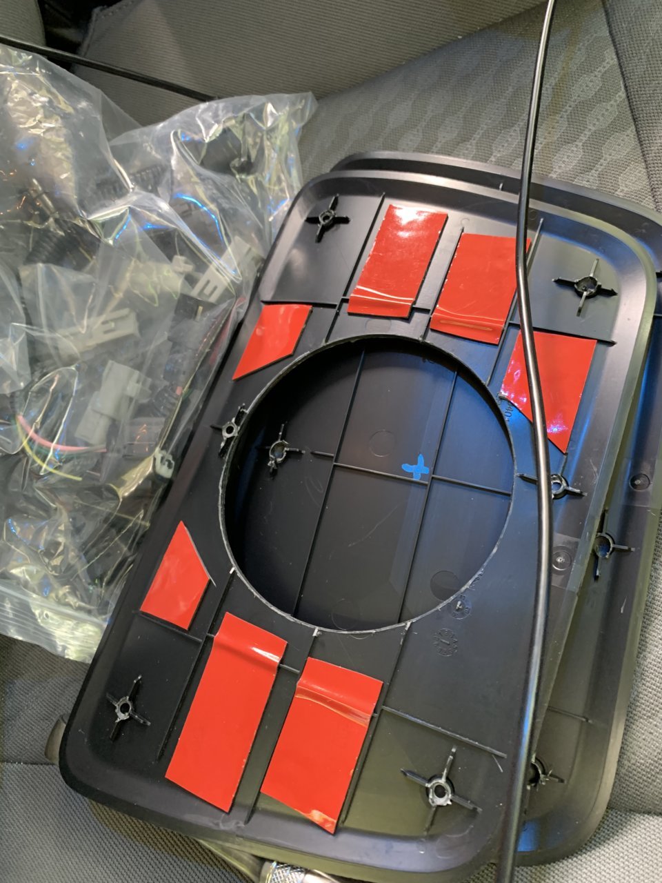

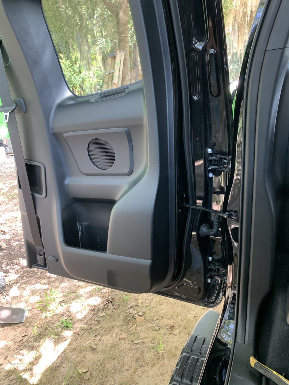

    Finished the install y’all! Keep the covers and drill hole. Looks legit if you ask me.

    That looks great!
    Do you get any rattle or buzz from the cover panel?
    Nice simple solution

    Non. No rattling or vibration.

    that's great! might just be the cleanest way to go

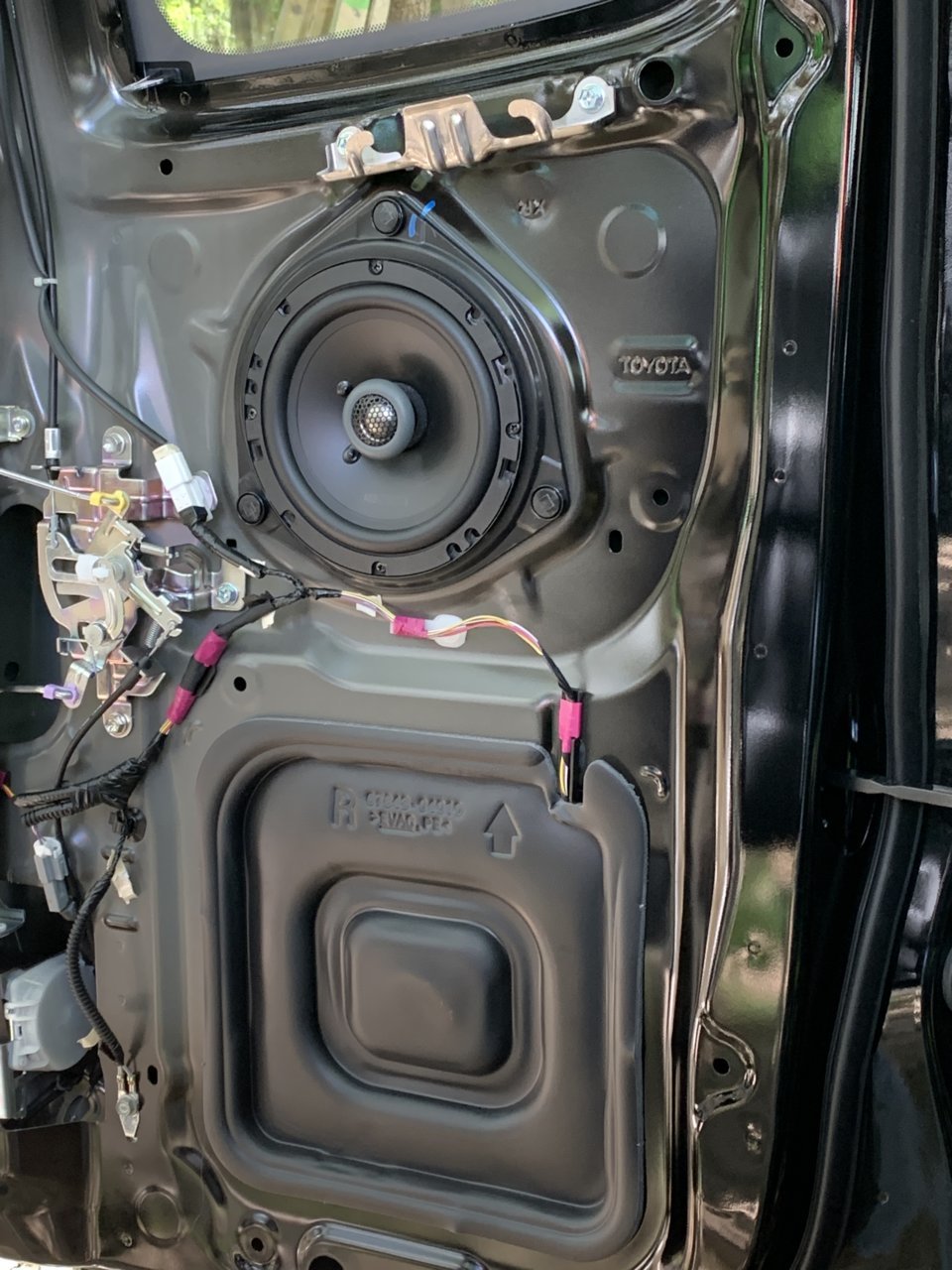

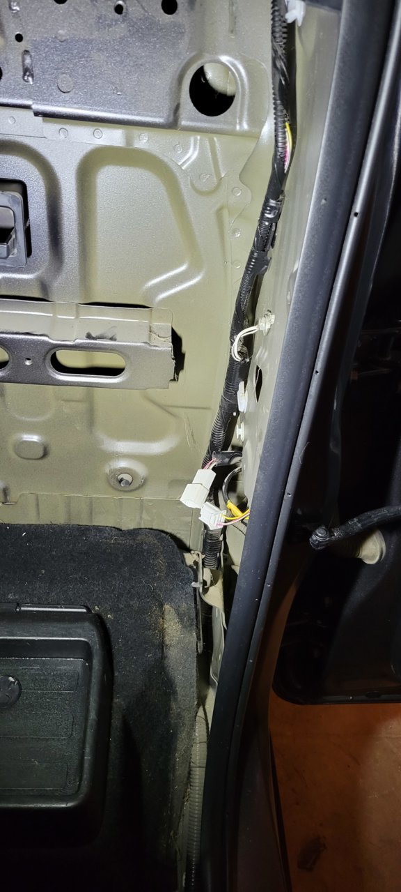

    20220119_173505.jpg 20220119_173509.jpg step 1: pull panels
    step 2: follow the harness
    Step 3: find white and black thick wires
    Easy peasy.
