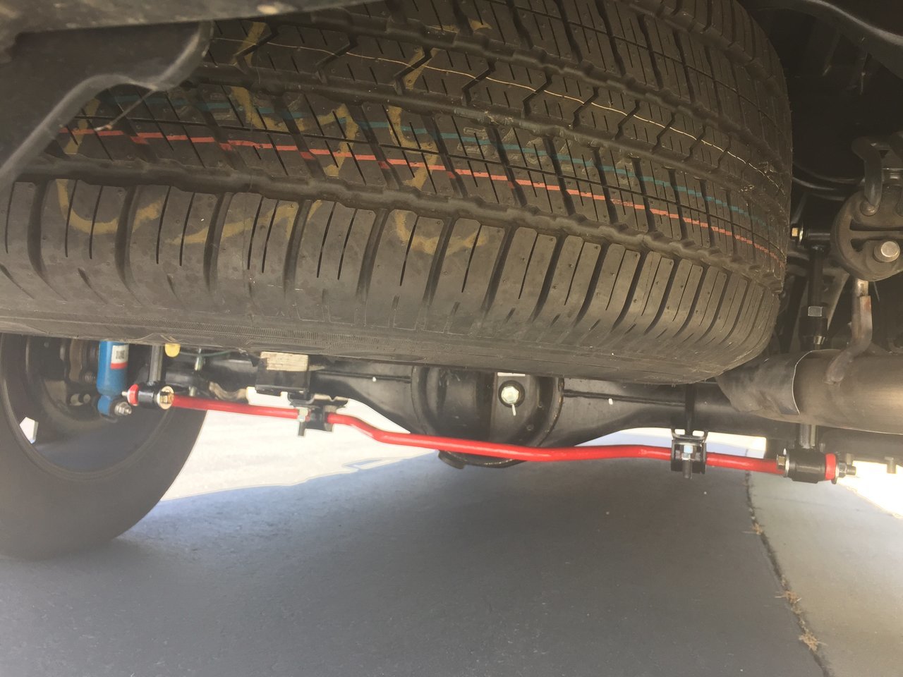

    installed today. took about 2 hours because I've never done it before and wanted to measure two hundred times and drill hole in frame once. It was easy, and I think IMG_8930.jpg realistically, if you've done more than one, you can probably install in 20 minutes.

    Who makes that one? and what are your first impressions ?

    This is a Hellwig bar.
    It's only been one commute to work and back. Initially, I can feel some improvement in body roll. I'm going to have to play with it a bit before I can give good feedback. I already want to move to the medium setting to experience that as well. I'll post back once I can provide solid feedback.
