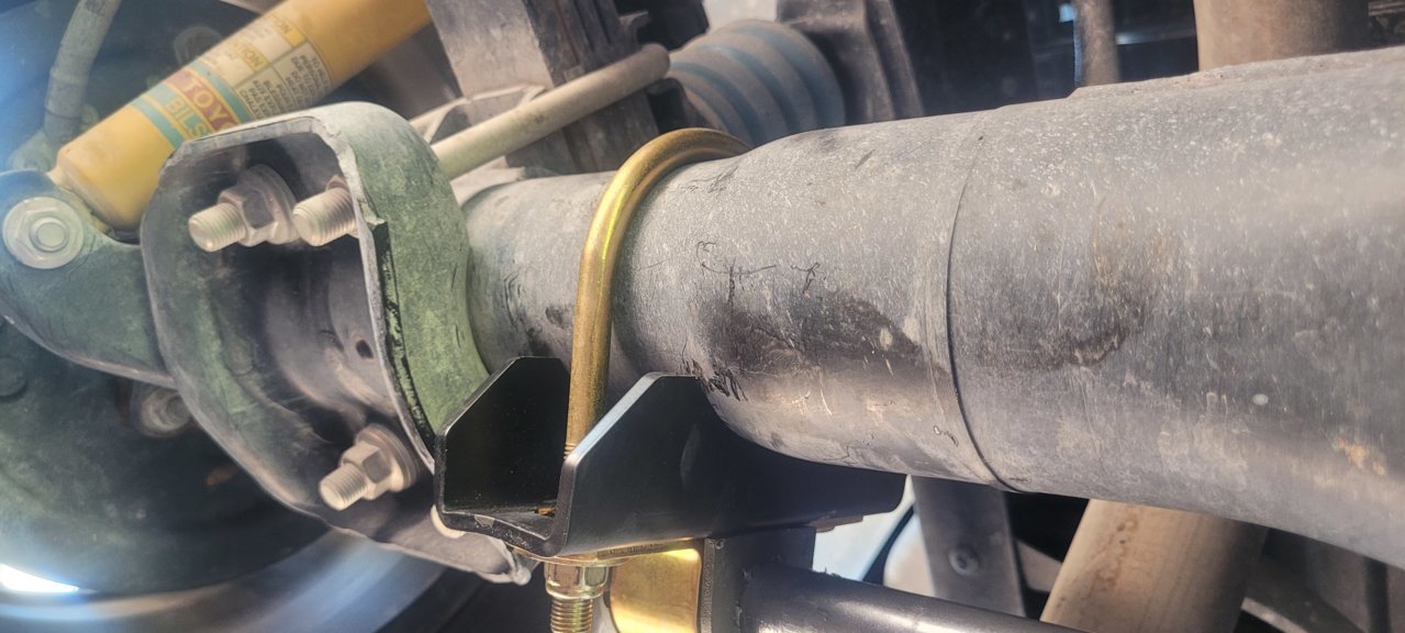

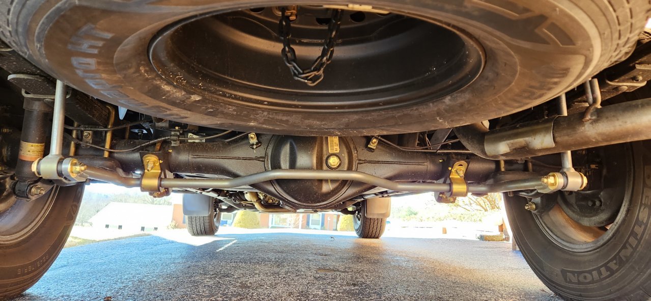

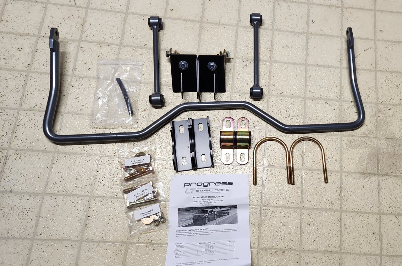

    Anyone familiar with all the sway bar options?
    Hellwig (7744) requires drilling into the frame to install.
    Progress Tech makes a bolt on option for the 3rd gens that does not require drilling to install.
    Is one mounting option superior to the other?
    Is the bolt on weaker in any way?
    Is the slightly different geometry because of the mounting something that will affect handling?
  9. Aug 29, 2023 at 2:45 PM
    #69
    Drippy4x4
    Drippy4x4 Keeper of the Air Dam
    Oct 16, 2021
    #379781
    43
    '22 SR5 Taco
    As far as I know. I'm the only member that has The Progress Tech sway bar kit.
    I recommend it over the Hellwig. All direct bolt on. No drilling. Very much OEM. 10/10

  11. Aug 29, 2023 at 7:06 PM
    #71
    faawrenchbndr
    faawrenchbndr Til Valhalla
    Jul 17, 2011
    #60024
    2,590
    Greg
    Denver, Indiana
    ‘23 Sport 4x4 DCSB
    Load leveling hitch is a must
  12. Sep 8, 2023 at 9:13 AM
    #72
    metalmule
    metalmule Well-Known Member
    Jan 10, 2022
    #386890
    63
    21 DCSB
    Does your rear solid axle change in diameter near where the saddle brackets are supposed to be installed? Putting them on the smaller diameter portion of the axle means that they are very close to near where the sway bar curves while putting them half/half on the thicker/thinner portion of the axle means that they sit at an angle and not perfectly perpendicular to the sway bar. Did you have this issue?
    SUMOTNK likes this.
  13. Sep 22, 2023 at 1:23 PM
    #73
    Drippy4x4
    Oct 16, 2021
    #379781
    43
    '22 SR5 Taco
    Sorry for the late response. I didn't get any notifications.
    As far as your question goes. I'm not quite sure if I understand your question.
    I mounted the included saddle at a tilted position to position it away from the brake lines. As far as the bar being perpendicular, it rotates to align with the sway bar end links, which is already at a fixed point attached to the frame.
  14. Sep 25, 2023 at 3:46 PM
    #74
    metalmule
    Jan 10, 2022
    #386890
    63
    21 DCSB
    The axle gets thicker near where the saddle brackets mount, they end up sitting slightly sideways so that everything clears properly.
    It seems like it would make more sense for them to go on the thicker portion of the axle but the U bolts don't fit.
    3JOH22A and AmateurTaco1313 like this.

  16. Sep 25, 2023 at 4:49 PM
    #76
    Drippy4x4
    Oct 16, 2021
    #379781
    43
    '22 SR5 Taco
    Ah gotcha. I didn't realized it was a difference in width.
    Alternatively, you could get someone to weld those saddles on the larger width end and have it be a permanent fix point.

  20. Dec 5, 2023 at 6:08 AM
    #80
    metalmule
    Jan 10, 2022
    #386890
    63
    21 DCSB
    I contacted the folks at The Progress Group and they fabbed up some saddle brackets for the stepped axle and shipped them out at no charge.
