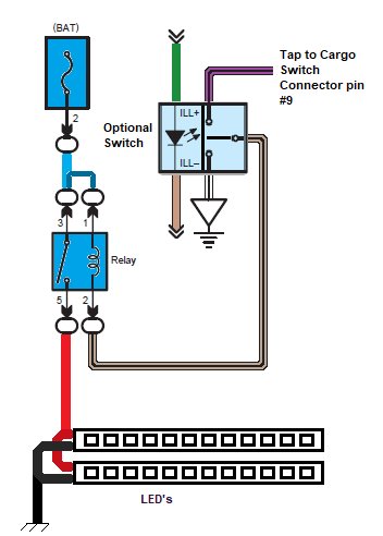

    Then it would be 2 positives on each side and, if you prefer, 2 positives to the relay.

    Sounds good! I appreciate the help

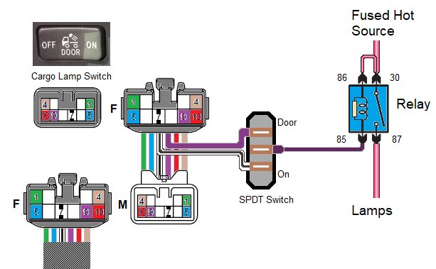

    Relay needs fused battery power, not IGN sourced, for the unlock, door open illumination.
    @kmorgan3 has the T harness to intercept the circuit without cutting the OEM wires...

    also noted and thanks for the heads up! I wouldn’t want to cut into the OEM wires :thumbsup:
