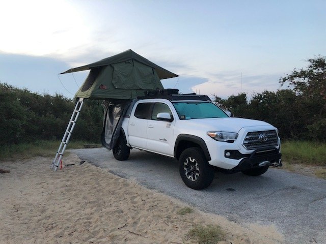

    I have a SSO slimline and a Smittybilt x20 with synthetic line. I saw maybe an inch of drop in the front, and it doesn't nosedive too terribly. It'll work for now, but I'd eventually adjust your suspension. Ill be going the OME Nitro Charger route next month.IMG_5535.jpg
