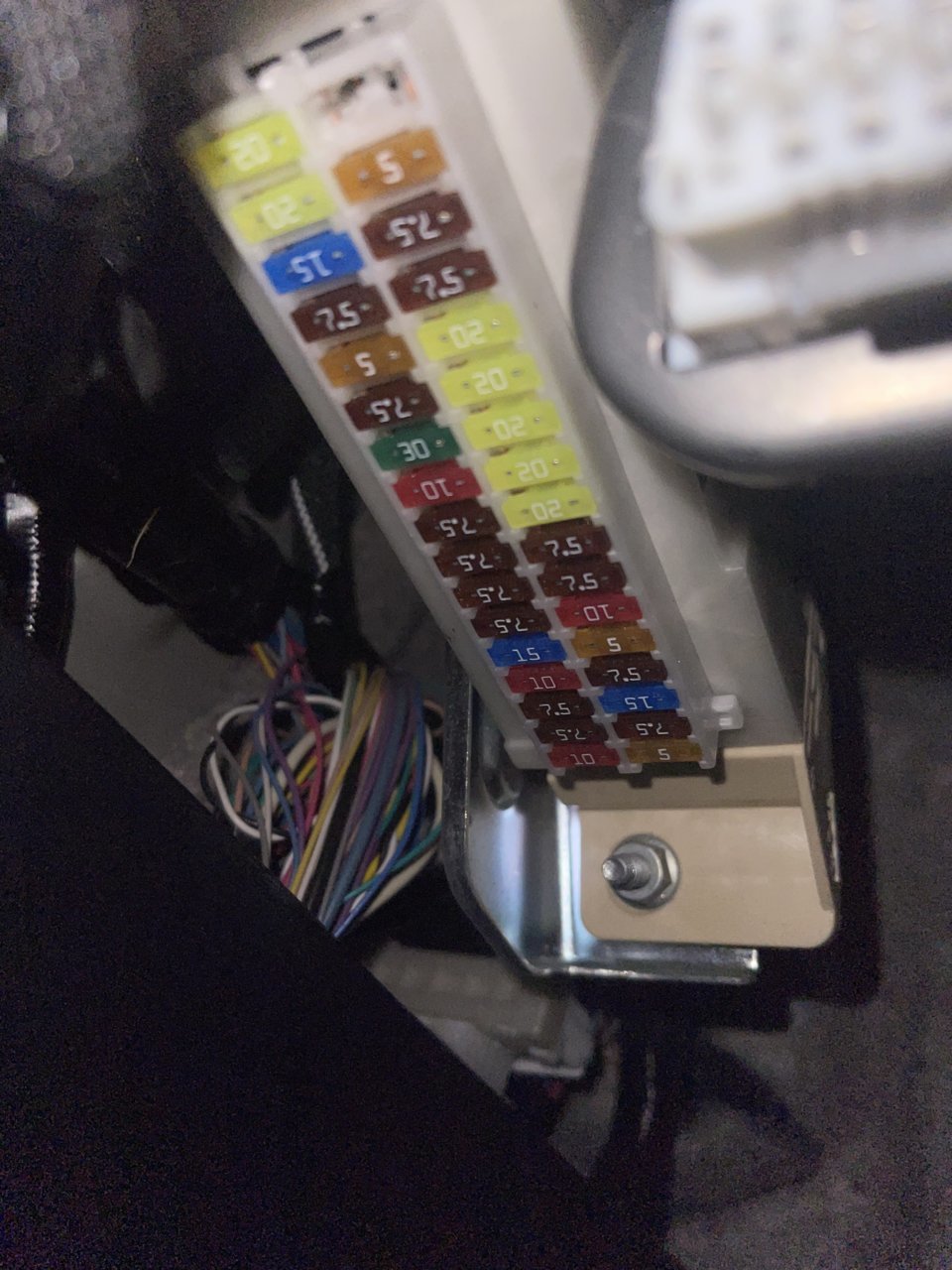

    I see the fuse panel and one empty slot where a fuse could go. But where would the positive wire connect to the fuse. Does fuse panel need to un bolted and pulled down to see where a wire could be connected?

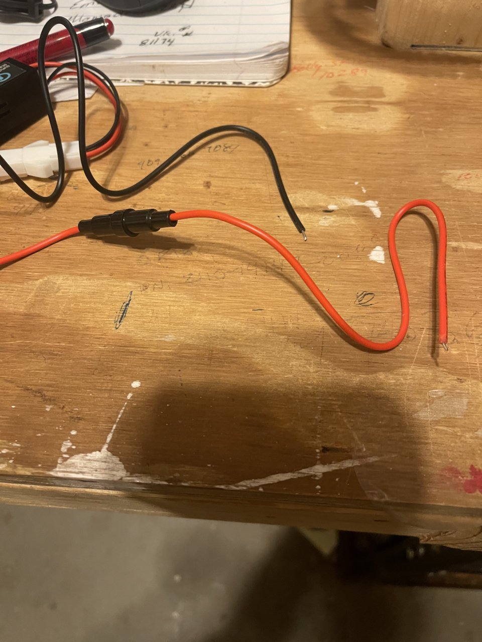

    My dual usb came with a fuse, I guess what I’m asking do you just jam in in beside one leg of the fuse, I took a pic but haven’t figured out how to up load it yet.

    This is the Q-com dual USB 3.0 and it comes with looks to be an inline fuse. I just need to figure out where to get 12 volts on the red wire and I will just ground the black wire, I guess I would like to know the best source to get the 12 volts.

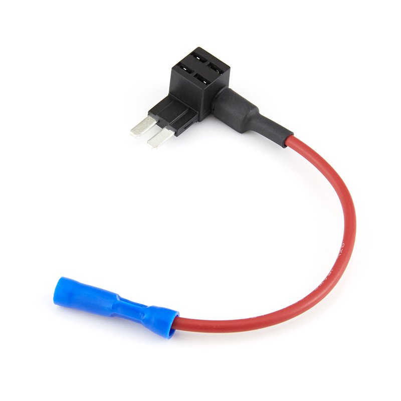

    Do not jam a wire in the fuse box. Use one of these (available on Amazon and at many parts stores).

    Wow, thanks for this picture and info. Will order today

    What is this called?
  17. Apr 18, 2023 at 3:50 AM
    #17
    ktbell444
    ktbell444 One who throws exceptions
    Aug 8, 2017
    #226306
    2,969
    ᚺᛖᛚᚺᛖᛁᛗ
    Add-a-circuit or fuse tap
    You should be able to pick them up at local automotive stores.

    I have got the fuse tap in, and is working great
    One question can’t get my fuse cover back on because the fuse tap is up too high, is there alternative fuse cover that might work to cover the fuses.
