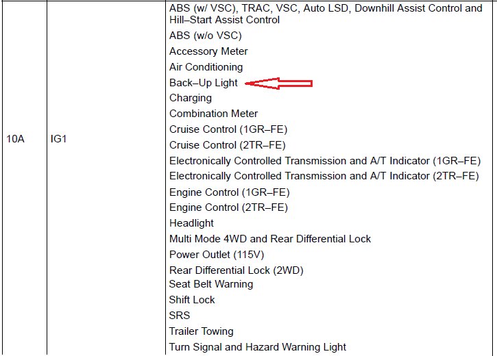

    You should get the camera it's own separate fuse. Just use the reverse as a "trigger".
    Many circuits are on that 10A IG1
