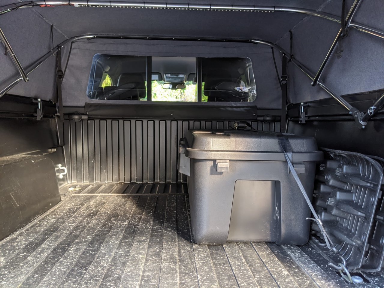

    There are a lot of possibilities. I like the bed bolt D rings, accessory rail fittings, and stiffeners for my use. I have a 108qt Plano case that I strap on the right side.
    There are also the Toyota nets, bed divider, and bed extender.
    Someone recently posted a pic of small D rings that they installed on the cubbie fasteners for light duty stuff.
    My setup:

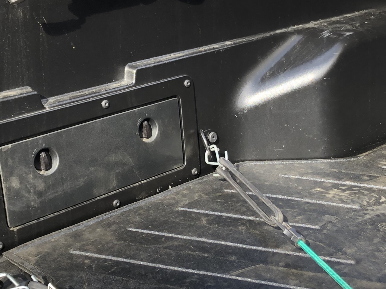

    Me. Which I shamelessly stole from a necro-thread that someone else revived. :anonymous: Great for strapping down the groceries. And they hold more weight than their diminutive size lets on.

    I put mine on the bed sides just behind the wheel wells and a couple of inches above the floor. The bed is molded in such a way that this is a decent spot to attach to.
    I might add a couple more, and like the spot where you've put them!

    I'm talking about the D rings you added in the center of your bed. I bought a couple of these and installed them on my bed sides. I'll take a pic later and add it here.

    Ah! Those are my most used ones. Being tied right to the frame is great when something needs to be cinched down well.
    A couple tips there:
    -- Testing the bolts before removal, they were torqued to 60ft-lbs.
    -- Do one bolt at a time so that bed doesn't shift.
    -- You'll need a T55 torx.
    -- I would recommend against grinding the shank on the bolt to remove the washers. A socket and hammer did the deed for me.​

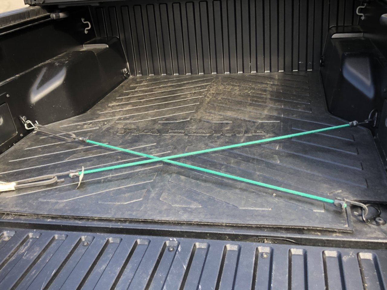

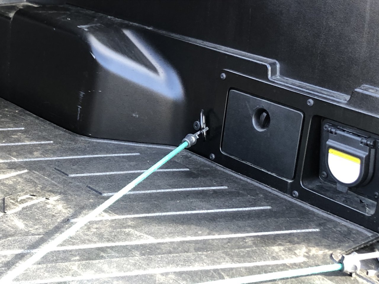

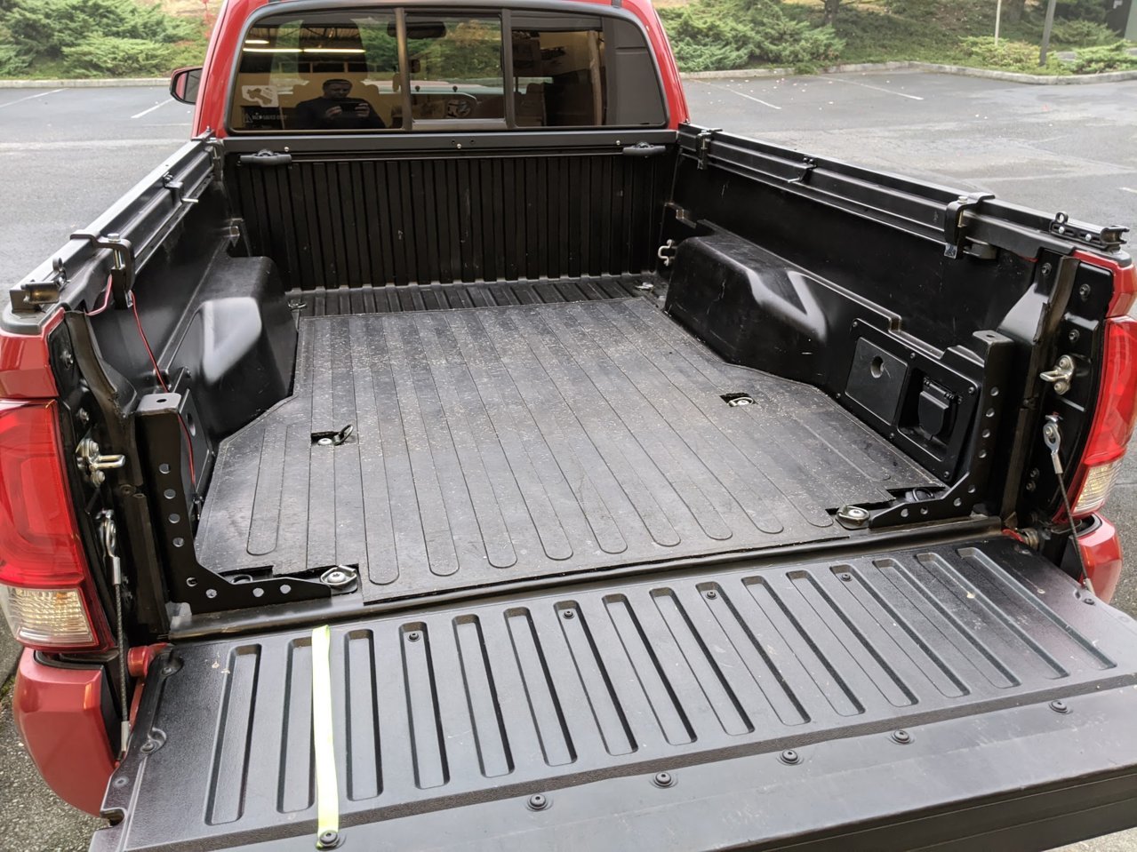

    This is where I added them... With this placement, there is a rib molded into the back side of the bed as a stiffener and the square backing plate of the D ring can sit against it. The rear wheel well liners hide the back side of the D-ring setup, but you don't need to remove them to install. It took less than 15 mins to install both sides.
