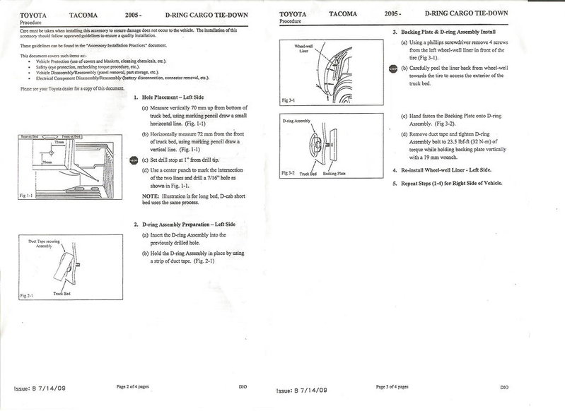

    I was about to add four d-rings to my bed at the bolts on the floor when I started reading the instructions which came with them. The d-rings were purchased from a Toyota dealer. I have attached a copy of the instructions. Let me hear some feedback. I like placement of these d-rinds but would like to hear of it would compromise the structural rigidity of the bed where these will be attached.
    Thanks
    RC
