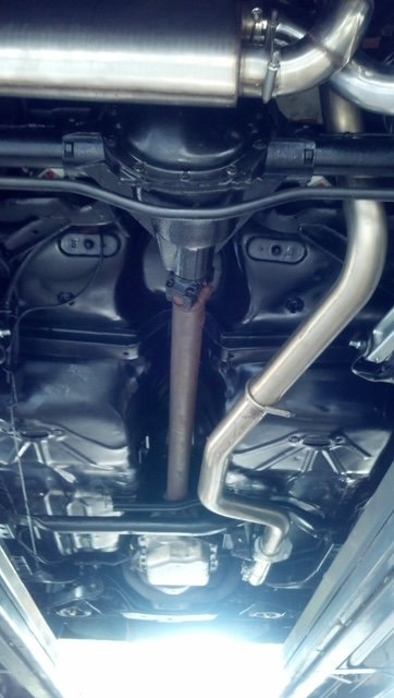

    I like using a wire brush or wheel, then Ospho to convert rust, and finish up with Rustoleum Industrial Enamel spray paint.
    If you want to get fancy, try POR15. I will go that route for a resto, but not for minor touch ups. The photo is POR15
