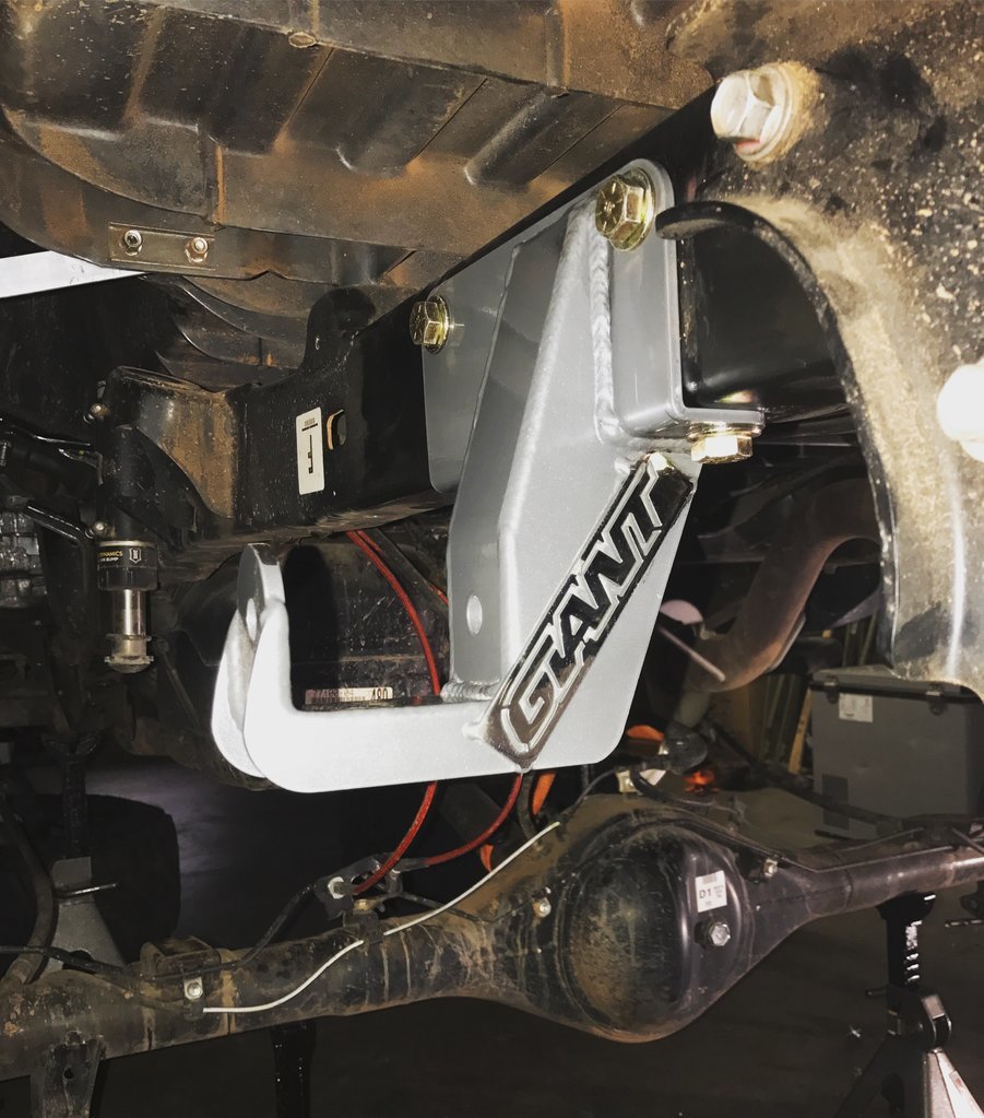

  8. Jul 4, 2017 at 4:16 PM
    #448
    erok81
    erok81 [OP] Well-Known Member
    Aug 15, 2016
    #194699
    5,708
    Imposter
    One bracket down three to go! Only one hole lined up so that was a plus! :oops:

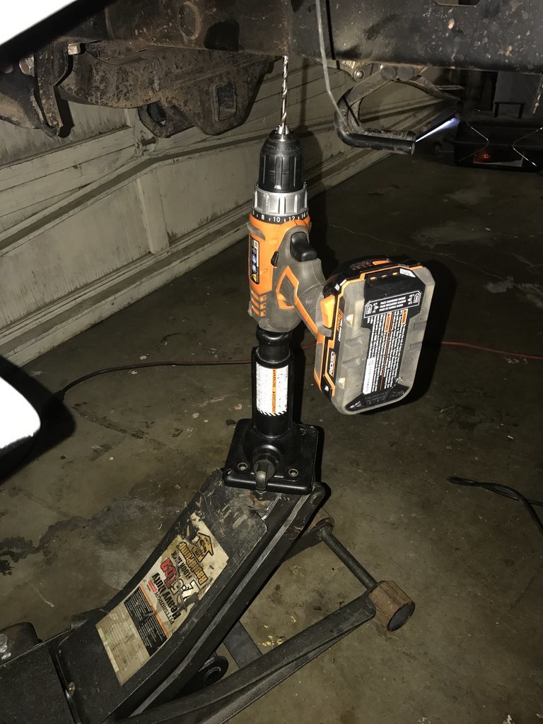

  13. Jul 4, 2017 at 4:57 PM
    #453
    erok81
    Aug 15, 2016
    #194699
    5,708
    Imposter
    Oh pro tip 3. Make a drill press using you drill and jack. In my case it's too high and I don't have anything laying around so I use my jack, truck jack, and drill! Makes for effortless drilling.

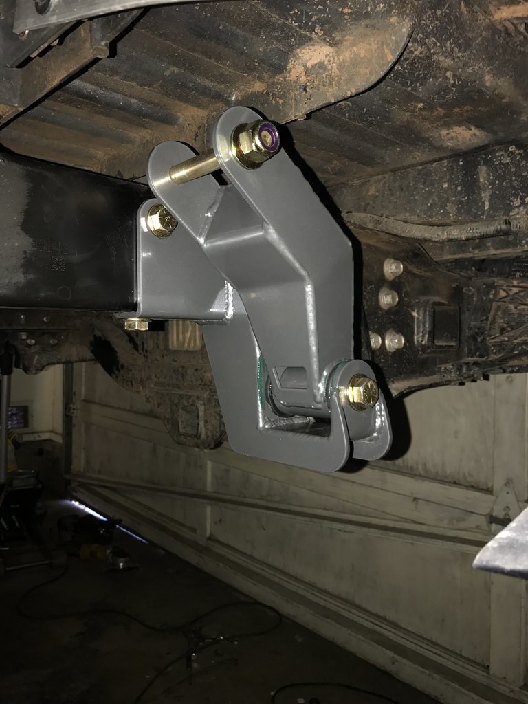

  15. Jul 4, 2017 at 6:21 PM
    #455
    erok81
    Aug 15, 2016
    #194699
    5,708
    Imposter
    This is quite the shackle. I'm going to have to trim my bed a little!

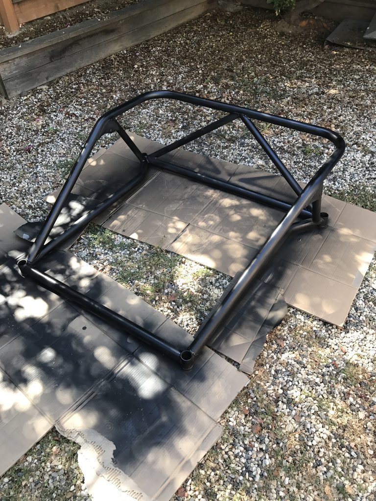

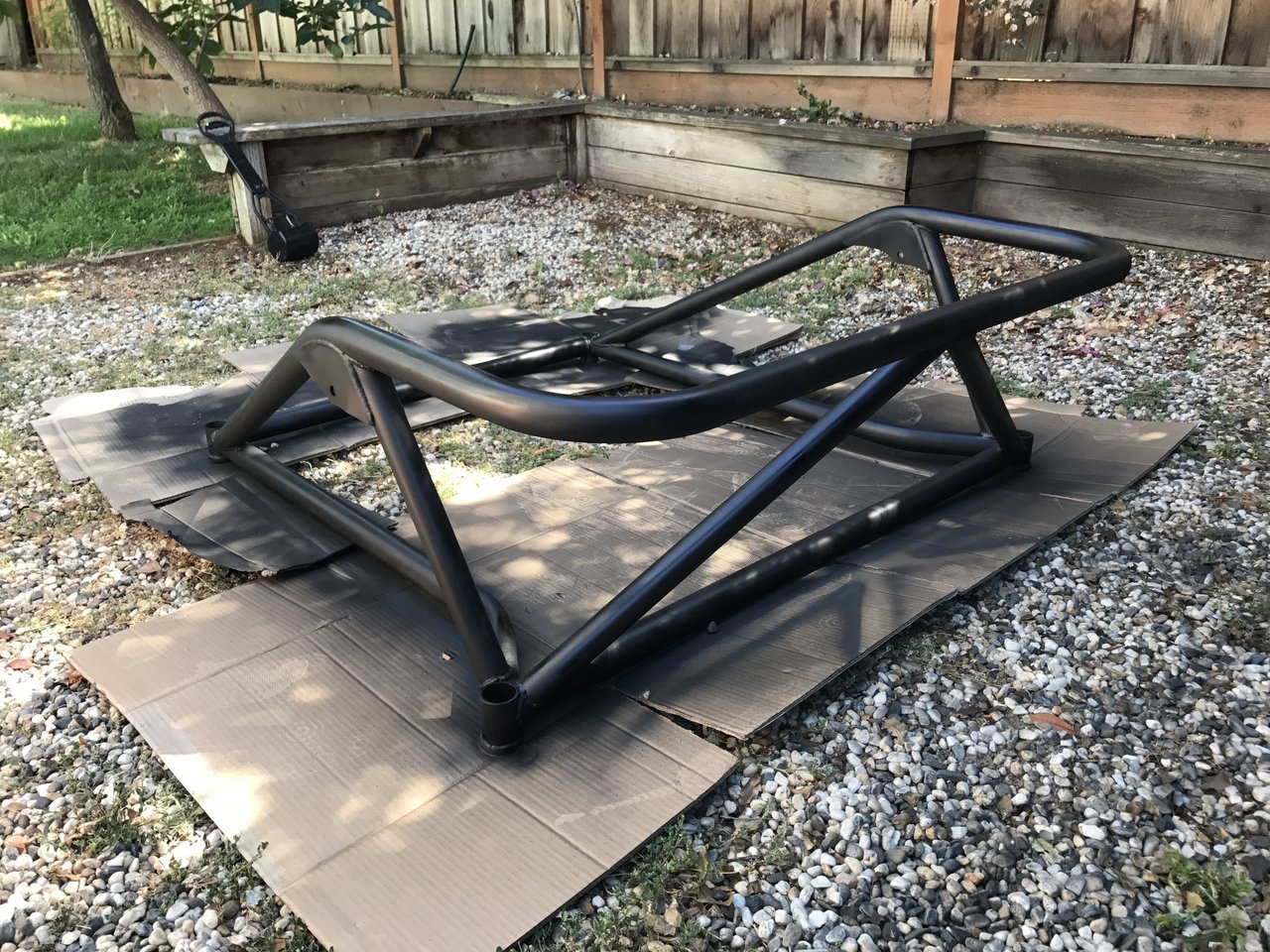

  16. Jul 6, 2017 at 4:23 PM
    #456
    erok81
    Aug 15, 2016
    #194699
    5,708
    Imposter

  17. Jul 6, 2017 at 4:25 PM
    #457
    Bentrodder
    Bentrodder PeeRunner Fanboy
    Oct 11, 2014
    #140142
    6,609
    Peter
    Cotati, CA.
    2015 DCLBFTMFW TRD Sport
    Kings and a TW DECAL!!!
    Is that a kit or did you have it built? Looks nice!
    erok81[QUOTED][OP] likes this.
  18. Jul 6, 2017 at 4:40 PM
    #458
    erok81
    Aug 15, 2016
    #194699
    5,708
    Imposter
    Both. It's a bed cage from Giant. You just call up and order it (I had to give him a few measurements though).
