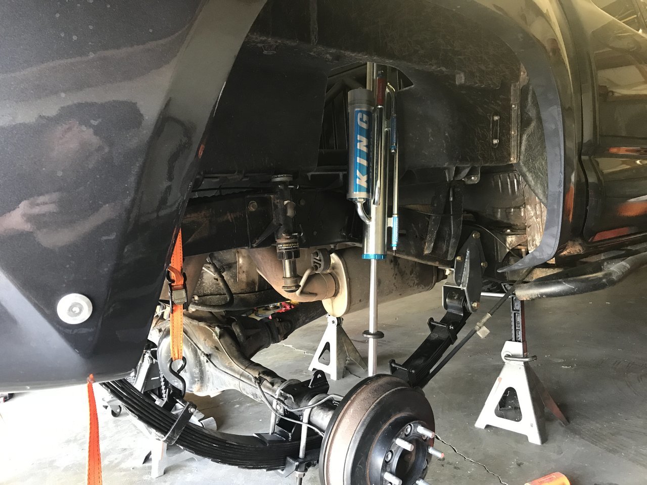

    I still have a lot left but it's official. I am done grinding and drilling.
    :bananadead::bananadead::bananadead::bananadead::bananadead:
    I'm leaving one shock mount on and one shock bucket thing. Maybe I'll find a shop to plasma them off. I'm not doing it.

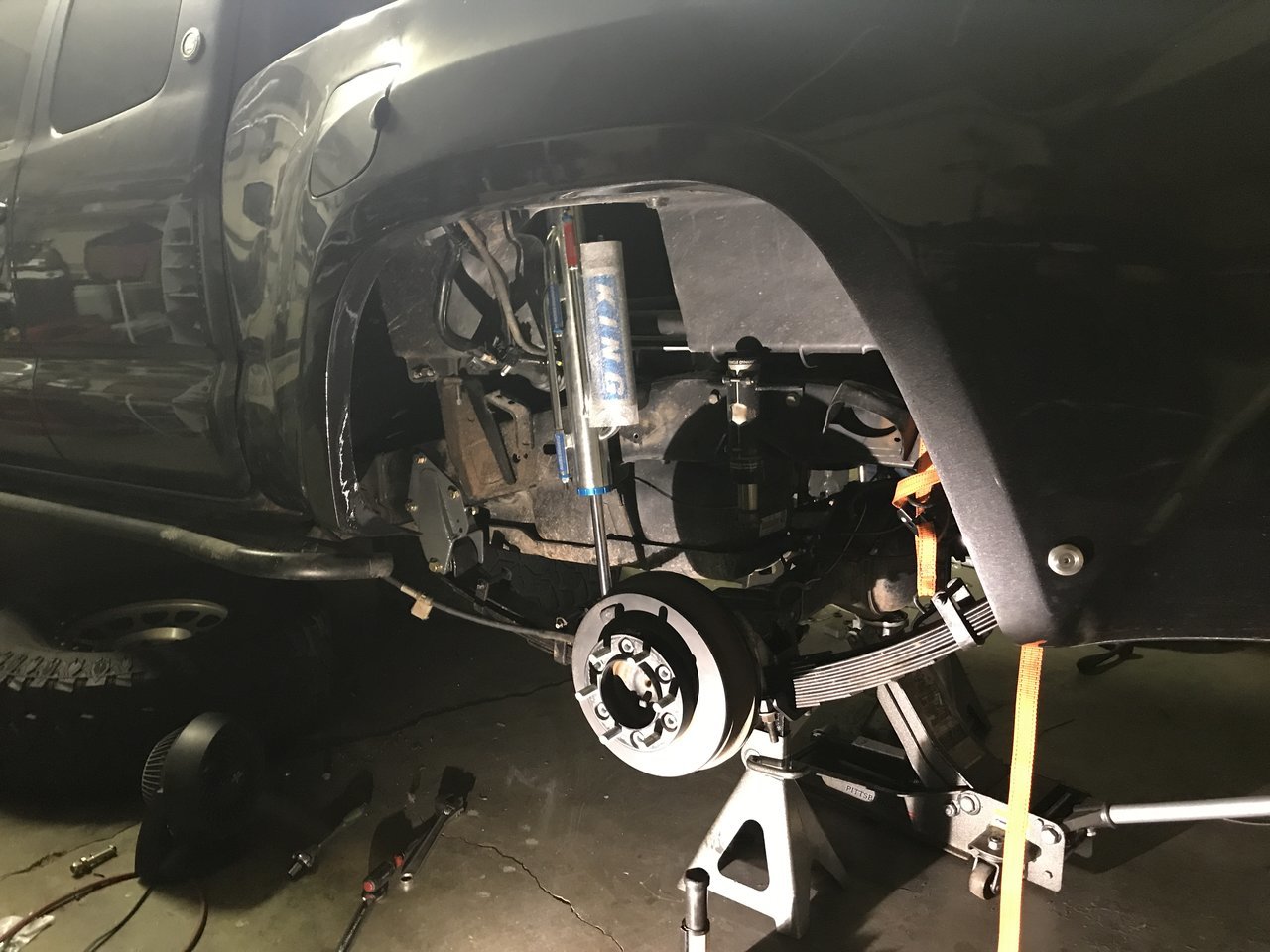

    Coming along I guess. Turns out I'm not done. There is another bracket I have to cut off. It hits the u bolt plate. :(:oops::oops::rain:

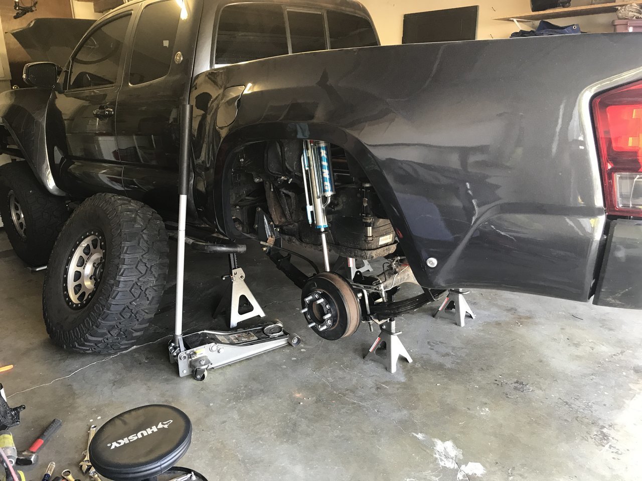

    Holding itself up! Still a lot left but getting closer!

    Although I have less uptravel than I did with a sprint over kit. o_O

    I thought sua would give you more up travel and your shock length/height would be the limiting factor. Is that right?

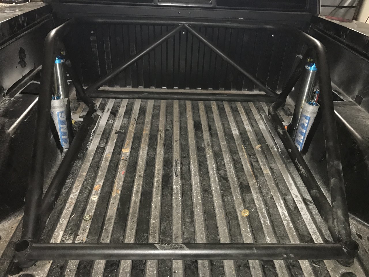

    Well that's a wrap! Just need to measurefor limit straps and extend a bracket. Then I'm done!
