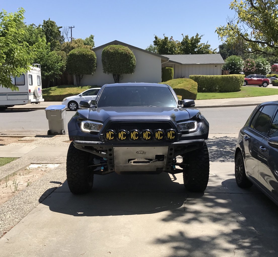

    Okay...the question of the evening is...am I really ready for 37's? I want to swap to an a/t so nows the time. It's been a few hours and I'm pretty sure the wheels and tires could be sold already.
    It's only an inch bigger on each side
    I can say it'll look a hell of a lot better with them. Currently I don't really like the way it looks anyway. Procomp has a return policy so I guess if they don't fit I could downsize back to a 35.

    As a guy who really wants to buy your 35s, yes. You are def ready for 37s ;)

    I don't know if the truck has been tested yet, but have you been able to go full stuff without rub on 35s? Im sure you can do it, just you might need to get more creative on the fenderwells?

    They slightly rub in a couple of places now - which most have been fixed. It's just reverse full lock now. I'm going to get one final alignment tomorrow and see if I can get some extra room. If not I'll just do 35" a/t's. Plus a rubbing all terrain will be better than a mud terrain. Haha

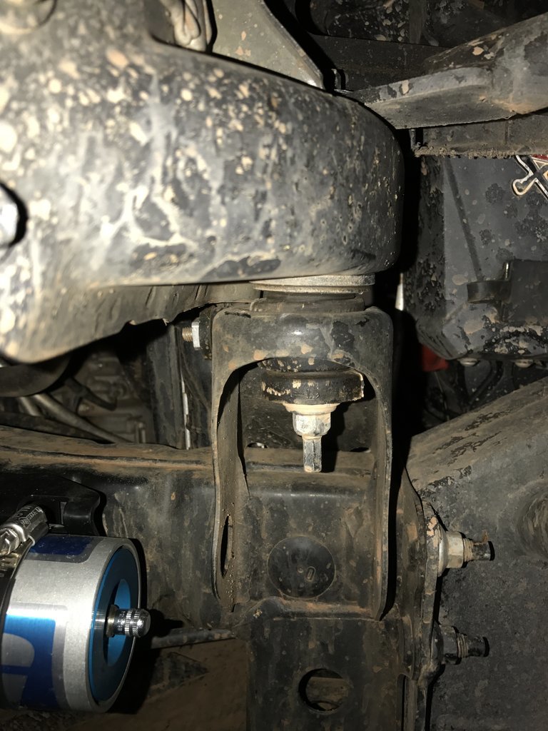

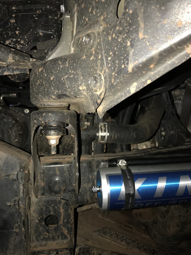

    @90yota
    Your front radiator support bushings. What did that sound like when yours were bad?
    I have a noise I cannot figure out. I figured it's the suspension and still think it is because the noise didn't happen until my new stuff is on.
    I've gone through the entire suspension (excluding anything woth lock tight) and loosened then retorqued. Test drive again for this last round tomorrow.
    It only does it over big bumps. I swear it's coming from the front but only happens once the rear goes over an offset bump - like taking a speed bump at an angle.
    The sound is kind of metallic. As a last ditch effort I looked at those bushings. I can insert a pry bar and they move fairly easily. But no noise sitting still.
    They definitely don't look the same either. But not necessarily bad...

    I had the same noise. You can't tell till they are out and realized they are shot. I wouldn't doubt it that was the issue. And for what $30 it's worth doing it anyway

    I bought them yesterday. Like you said, for 30 bucks why not.
