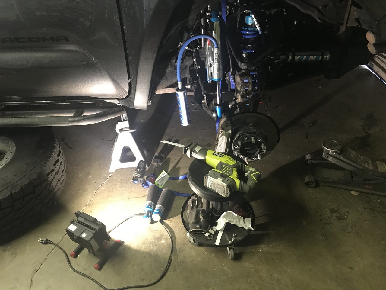

    Here we go.
    Operation make-37’s-fit-and-also-make-bumpstops-fit commencing now.
    :sawzall::sawzall::welder::welder:

    Haha. Just started.

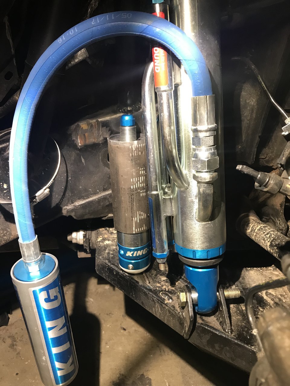

    Well. It’s either bumpstops or bypasses. Both won’t fit unless I notch my frame which I’m not doing.
    Stay tuned. King bumps for sale. :pout:

    Scratch that. If I cut off my limit straps and move them behind the bypass then the I can fit bumps. :crazy:

    Also who said you can tuck 37’s. Shock bottoms out before tire hits anything.
    With that said. I’m not sure I need bumpstops and can just use the bypass. I’ll put ‘em in anyway. :thumbsup:

    I have been told "Don't put it on any part of the arm other than where the bump pad is" because you will damage the arm over time

    I was going to add another pad in that area. But I don’t know what’s inside the arm there. :notsure:
    And it’s either there or I don’t run bumpstops at all. There is no chance they are fitting behind the bypass. And I’m not cutting a hole in frame right there.

    It astonishes me that everyone else on LT can fit bumps but your kit says "NO SOUP FOR YOU"
    That stinks man :(

    Its the dirt king hoops. No one else you’ve seen post have them. I have the very first set ever made. I think it’s because they tuck the shock pretty much parallel to the coilover.
    I know you probably think I’m stupid because I can’t fit them. If you want I can take a pic. I can’t even get half the bumpstop can past the bottom of the frame before it hits the shocks.
    Meaning if it tuck them up until they are hitting the bypass I’ll lose 3-4 inches of up travel.

    A few beers later a decision has been made.
    Bumpstops are going on. In the new spot. I don’t drive hard enough but really want the safety of a stop. I figure between the cusion of the bypass and the hydro bump the arm
    Will survive.
