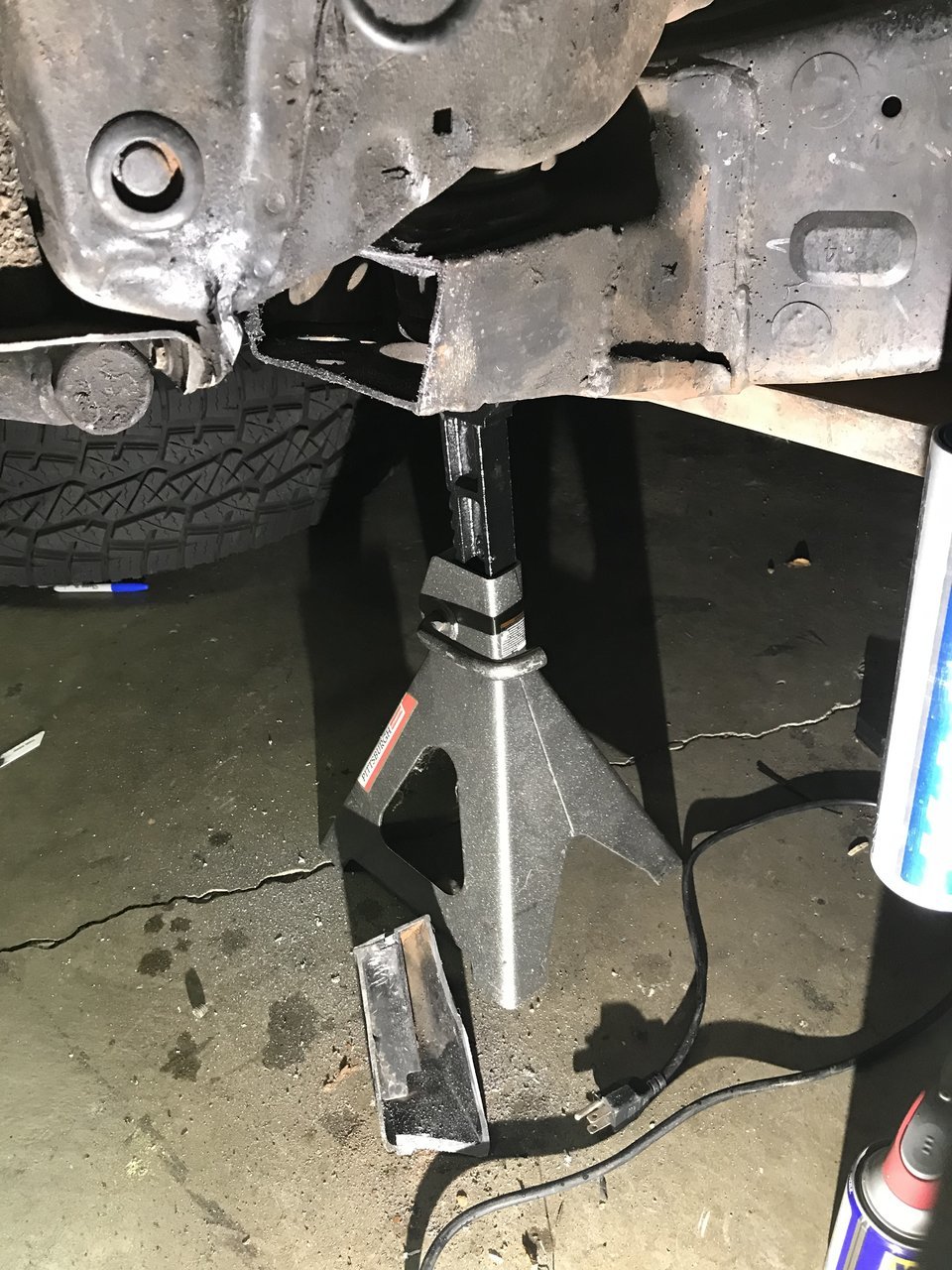

    Now this is a cab mount chop. Also if you are wondering it is possible to use a sawzall to cut a body mount. Just expect to sit there for an hour and lose all strength in arms. :rofl:

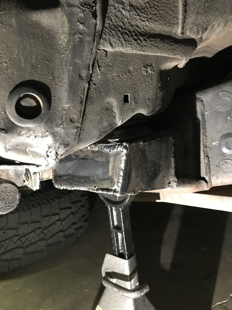

    How you going to weld the top of the plate? There is no way to get the gun in there unless you lift the body

    Good point. I might recess it in a little. Then I can get a full weld around it.

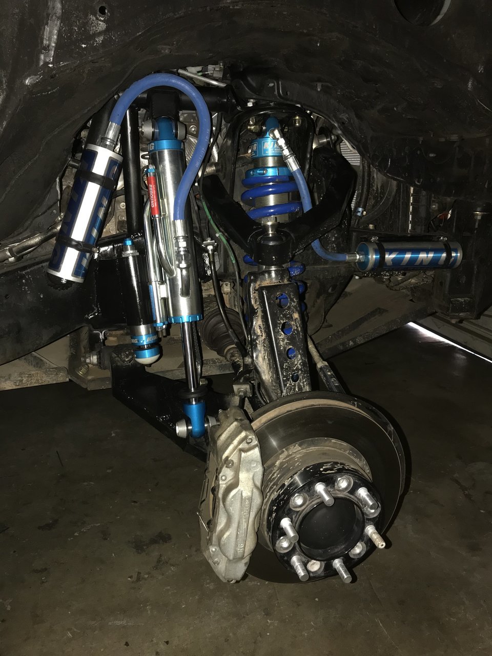

    Well there it is. :notsure:

    I know. Pos status.

    Na, so much want!! :drool:

    That drop tho :bowdown:

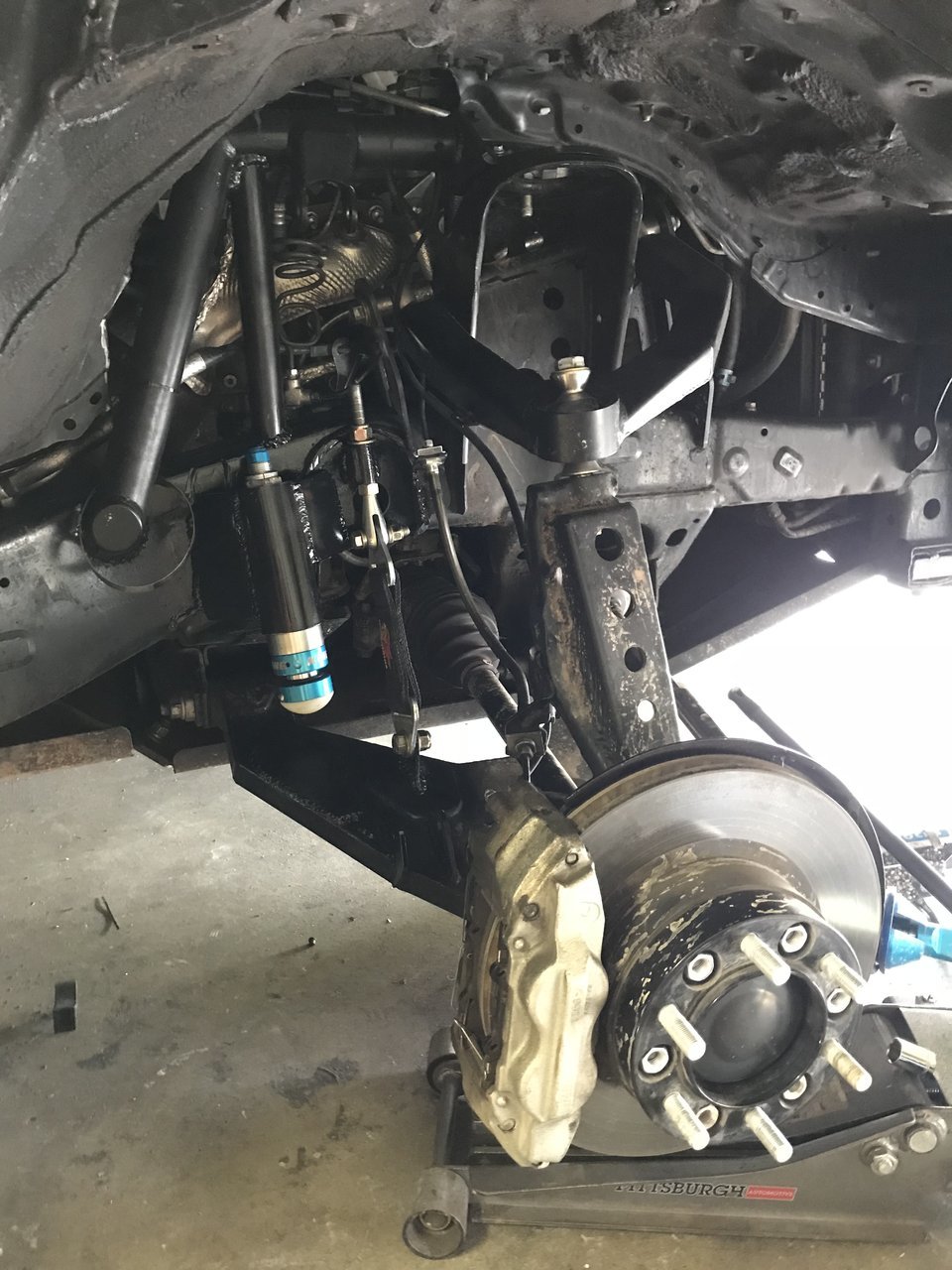

    @Caboose117 how much clearance so you have between your bump and the control arm at ride height? Mine is super close. I might have to shorten the stroke by an inch.

    @90yota good call in welding the top half. I was going to half ass it and leave the top open. But it’s pribably a good idea that I welded the top. Don’t mind the blue stuff on the top. The bushing got really hot and I tried to cool it with a sorta wet microfiber towel. It just melted.
