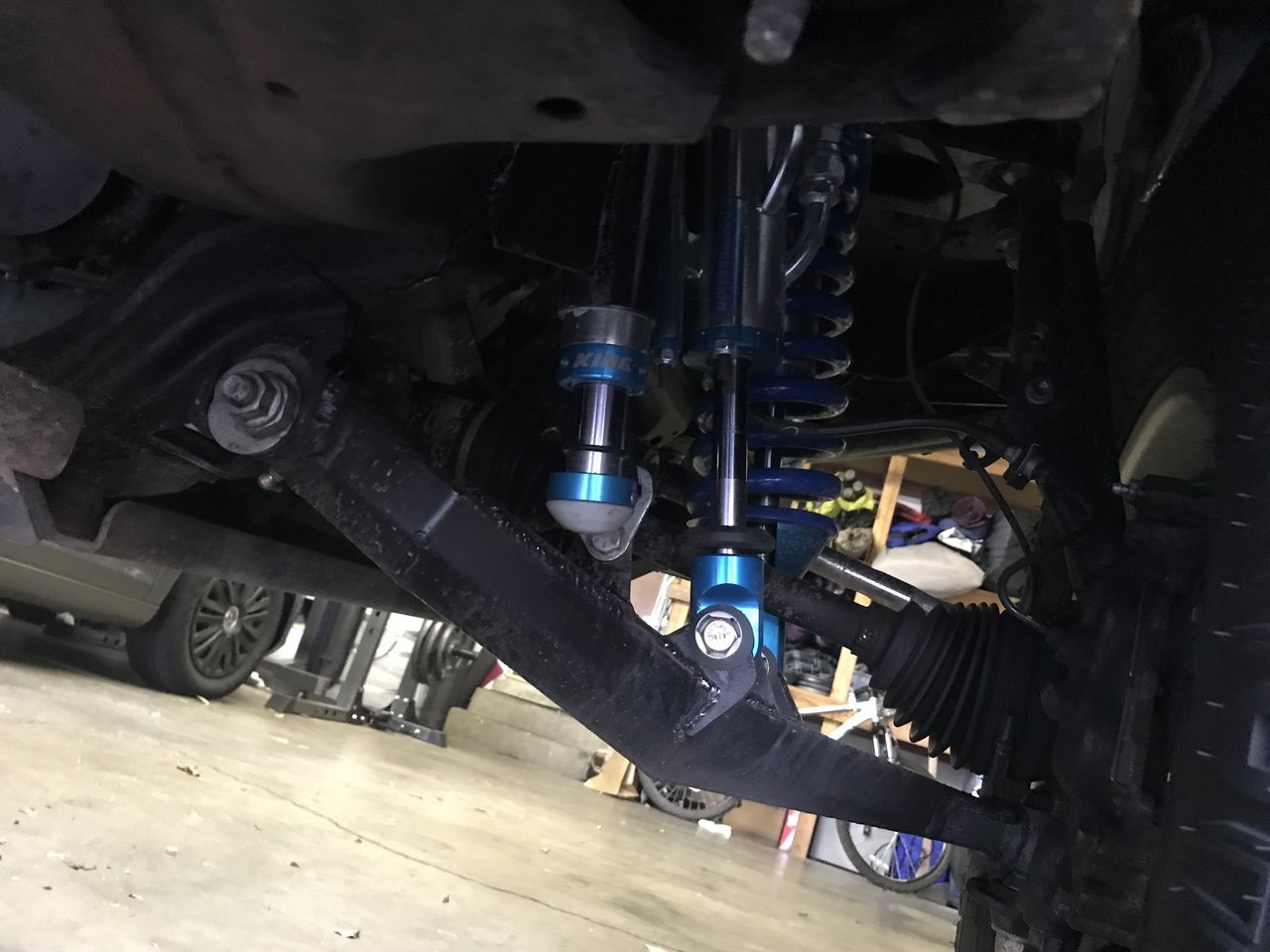

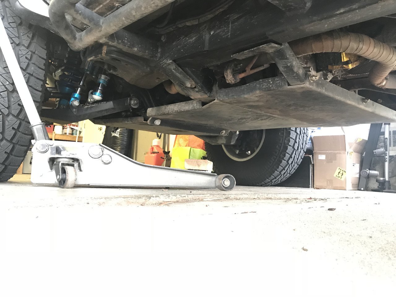

    Haven’t done much lately. Not much else to do I guess. Plus I haven’t been off road since I moved here so no chance to see what I need to upgrade.
    But I did a couple things today.
    First off finally fixed my skid plate. The gear shop didn’t install it correctly so there was a step in between the two skids. But now it’s all nice and flat again.
    While under there I can see how bad those hydro bumps are. Even in this pic it’s a little jacked up. Normally I have about 1/2” space between the control arm and bump. Which means I’m riding that thing most of the time. I think I’m going to get rid of them and put my super bumps in their place.

    Toyota lube techs did the same thing with my skids. Except when I was driving out of the dealership I heard a loud clunk going over the speed bump. Crawled underneath and found six out of ten bolts not even finger tight. Plus the big lip because of not putting them on correctly.

    Maybe it’s because I installed them in the first place, but it doesn’t seem hard to put those back on correctly. :rofl:

    Bummer man as Im sure you are getting tired of revisiting the bumps up front. You gonna sell the king bumps?

    It seemed like it was harder to fix them then it was to put them on initially

    Yep. Won’t come with mounts though.

    Hmmmm... ideas....
  14. Jan 18, 2018 at 3:52 AM
    #1254
    90yota
    90yota Instagram: 90_yota
    Apr 13, 2016
    #184183
    5,417
    Dixon, CA/Truckee,CA
    88 T4R / 15 F350
    Stock....ish
    What are you going to put back in its place?

    My old super bumps most likely.

    How are you gonna do that? Not gonna be easy at all....leave it

    Weld a flat plate to the king bump stop and bolt the super bump to it. Otherwise I am riding the bump pretty much constantly. Which also means I have to leave the pressure a little lower since it’s basicslly a third shock right now.
    If I put the super bumps back on I’ll get back over an inch of free up travel.
    I’m not 100% yet. Just an idea when I was under there last.
