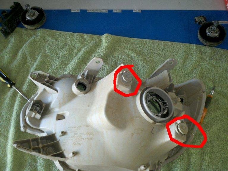

  4. Apr 8, 2013 at 5:39 PM
    deadhed61
    deadhed61 :notsure:
    Oct 23, 2011
    #65723
    8,106
    Santa Barbara, Ca
    The Black Pearl
    A little lift and a little armor
    These are them. I believe on is covered by a plastic cap tho.

  7. Apr 8, 2013 at 7:09 PM
    Rich91710
    Rich91710 Well-Known Member
    Feb 23, 2012
    #73470
    16,331
    Rich
    Los Angeles
    08 Base
    Satoshi with FJ badge, factory cruise, factory intermittent wipers, Redline Tuning hood-lift struts, Hellwig Swaybar, Rosen DVD-Nav
    Top one is horizontal.
    Bottom one adjusts up and down.

  9. Apr 8, 2013 at 10:59 PM
    Rich91710
    Feb 23, 2012
    #73470
    16,331
    Rich
    Los Angeles
    08 Base
    The "knob" is locked into the housing, but the "nut" on the end of the screw that is attached to the reflector can run off the end of the screw.... but on a lifted truck, you're going the other way, pulling the bottom of the reflector in.
    These are seriously fine thread. A full turn on the screw makes a difference of maybe 1/4 inch or less at 25 feet.
  10. Apr 9, 2013 at 7:01 AM
    XXFattyHunterXX
    XXFattyHunterXX Well-Known Member
    Sep 18, 2012
    #87200
    136
    Westminster, Colorado
    T4R
    Makes sense, but what about the top knob for horizontal adjustment? Seems like I have to bring the 2 projector inward therefore turning counterclockwise, will turning too much making it come loose?

  13. Apr 9, 2013 at 10:47 PM
    XXFattyHunterXX
    Sep 18, 2012
    #87200
    136
    T4R
    Thanks rich, guess I'll try it tomorrow, the light is spreading way too much to the sides so I am not getting lights in the middle much.
